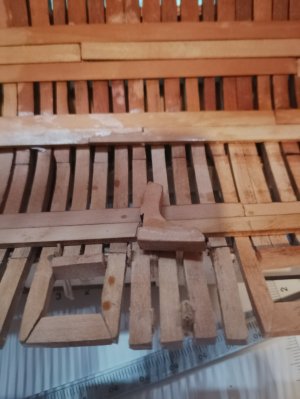

THis is the problem
Can you see how the hanging knee is away from the Frame
I am going to buld the same Beam for the Gun Deck to see if its the same
If it it is OK We will not be able to see that lower Hangin Knee (Wonder what the last few Non "Hanging" Kneees Will Do Might lake up one of those

All the knees are somewhat tricky, you need to alter them a fair amount with taper, bevel, notches for deck clamps to fit close to the frames as well as following top of beams.
Your image, for instance, the notch of the knee needs to be re cut to allow for the deck clamp.
Doesn't take a lot of time to bring it in closer to the frame

Photo shows the the Hanging Knees are away from the FRames
So need to .Adjust the Lower DEck Hanging knees
So ive prepared a Gun Deck Hanging Knee and It (k!)needs a much deeper slot for the Thick Stuff and a thin slot for the Inner Planking below the Thick Stuff
not happy with quality of my work but might be getting there
first picture id lower deck hanging knee
second is gun deck hanging knee
What is really needed (I think) is the knees fitted on JUST the Thick Stuff and then fill with LOwer Inner PLanking) which would be fitted AFTER the knees but not sure it is possible

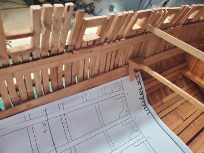

Hanging Knees are NOT touching the Frames but they are close
Will add the DEck Supports as I go

Ive started fitting the Beams
Now making them as i fit them It means I can get it as near rightas possible
The Hanging Knees are still away from the Frame
I think Once Ive fitted Beam 3 I can get the Fore SEction in exactly the correct place Using Its uprights as Uprights
Then Beam 4
It looking easier that way
Your build, can go in any fashion you choose but FWIW, I think for lower deck, you want to fit knees, etc. every single beam as you move through hull......far easier and everything remains tight.
That was my experience.
