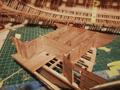

You take the sheets supplied, you get the strip stock and square stock and scratch build them using the sheets as template. The PDF letters only correspond to what bulkhead on the sheet locates where. Take a hard look at the individual sheets and it becomes fairly intuitive as to how constructed using what material.This is why you have plenty of strip/squar stock on sheets.Take particular care locating platforms for and aft. Plans show you where as to EXACT beam they locate, as well as compartments. Fail on this and all will interfere with hanging knees when installing beams. Here, the instructions are fine ......I had zero interference with knees
Sheets, be forewarned, are not exact especially as to height and the bulkheads that span the hull. You need to take measurements and build accordingly.
Lower doors, also, scratch built from strip, as is upper/lower well.

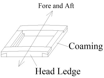

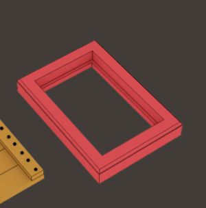

simple coaming for hatch on platform.....made mine from 3x3 strip as with all lower deck coamings. Not strictly correct via morticed joinery but.....there it is.
but i wish they would show simple illustations rather than What it should be likesimple coaming for hatch on platform.....made mine from 3x3 strip as with all lower deck coamings. Not strictly correct via morticed joinery but.....there it is.
As stated this kit does not follow contract as to EXACT construction.
