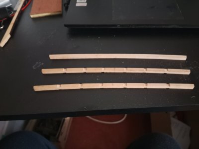

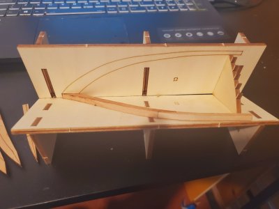

While i am waiting for the Hawse Pieces i decided to start Cutting the BEAMS
So Its the instructions that are not good
With help there are three sets of Beams
D1 and D2 LOWER DECK the illustration show how to cut a (Fore) and b Stern Cut outs for Carlings
D3 and D4 GUN DECK
E1 Is UPPER DECK
Unlike the Brandford where its a sandwich of 1Thin 1 Medium and 1 Thin which puts the Cut outs on the beam correctly placed
I guess because of wood colours people didnt like this so we cut them out ourselves
Once i worked it out its VERY easy made a jig for 4mm Carlins and flicked the middle out with a number 22 blade (Which id curved)
I Just wish it was in the instructions Not everybody has build POF Ships
D3 and D4 GUN DECK
E1 Is UPPER DECK

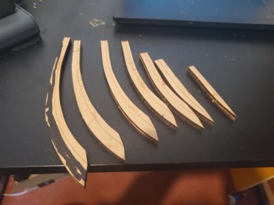

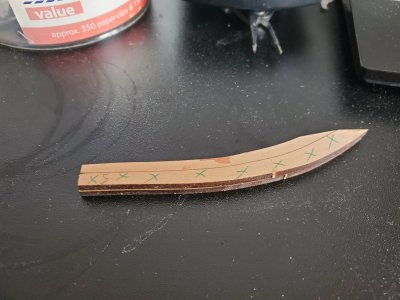

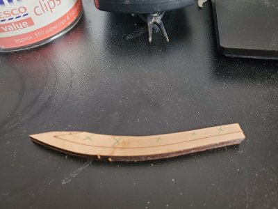

restarting the Hawse Pieces
Like others i cut the wrong side so marking the side that needs triming might help

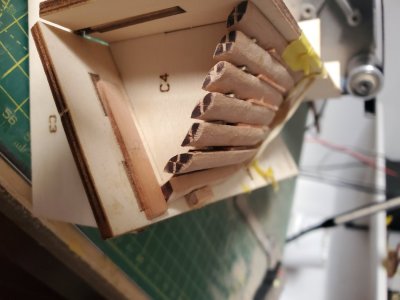

Just a hint When you do your hawse pieces
Ive very lightly tacked 6 and together while i do X8 and 1 to 5 so i can place it instead of it slipping off the joig
Just seems to help
I have suggested to Victor that on their next build they mark the part to remove on the Hawse pieces
Also Ive built the first side - needs tidying up

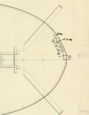

Incidentally should the top of the hawse Pieces be square

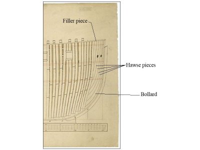

Hi Richard,
The top of the hawse pieces formed nearly a parallelogram. There would be a slight curve when finally shaped though. From the contract for Enterprise class vessels, on each side there is a bollard sided 12", then a 14" hawse piece, then two 13" hawse pieces, then a 14" hawse piece <and filler piece> The top of the top timbers forward was 4" thick so I am assuming the top of the hawse pieces would match so the planking would run smoothly inboard and outboard.
Hi Richard,
if you look mne have gaps did the filler come up to the top
But different height is intetsing

Would the planking go over the top of the Hawse pieces

I am also having a bit of trouble getting the lower end onto X8a
Luckily I am using glue that i can remove
Slowly getting these

Sorry Richard, I have no idea what the kit provides. The contemporary framing plan HIL0079 which was for Medea and others in the Enterprise class below might be some help.
Thanks Jeff,
Unfortunately, per the contract and drawings what they expect is wrong. There were four hawse pieces plus the bollard and filler piece on each side, not five hawse pieces, This will create problems getting the hawse holes in the right place between the appropriate hawse pieces with the correct distance center to center.
I should be able to get the correct spacing between the hawse holes since I'm putting a 3/4" tall piece between each of the hawse pieces right along where the holes will need to be drilled.
I think they are using 2 pieces for the filler piece so they don't need to provide another thickness of timber in their kit. But, that is just a guess on my part.
I did notice that nowhere in the instructions to they mention the hawse holes. :)
But that's not too hard to fix.

From the contract:
the diatr of the Hawse Holes to be 11ins & 13ins asunder at least on a square, the holes to be lined with thick Lead, not less than ¾ ins .
I was surprised the space between the 11 inch holes was only 13 inches.
This may be a repeat, if so, my apologies.
From the contract:
Thank you very much ! I only have the holes shown on a side view in the plans. So, to be accurate, they need to be 0.2291666666666667 inches in diameter on the model... ROTF ROTF ROTF

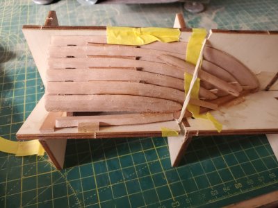

Havig a bit of a problem with the Hawse Pieces
Very carefully Trimmed Top and understide as per Marks
THis includes the "Step" on the Inner Pieces
When i came to fit them the step was apparenly wrong and fits better and neater without
BUT it shows on the inner side by the Bow
JUst be cafreful to get this right before you cut these pieces
I have glued the Bow side of the Hawse set to the Bow and then waitec for it to dry so i can "Stretch " X8A to Meey X8B
I think then is the time to fit the Fillers on the Upper Hawse Pieces
