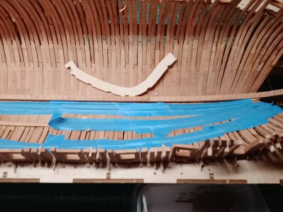

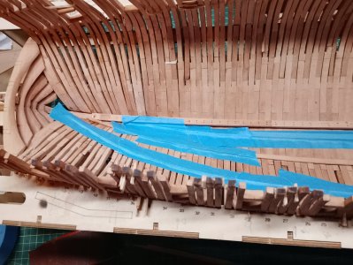

While I am waiting for my New Hawse pieces I decided to Clean and attach the Inner Planking - although its more of the supports
Getting them to stick to the Inner Frames has been a nightmare
Using 3M Tape seems to be good
Have marked to position with the Jig Pieces (One Shown)
Once 2,5, 8 have dried i will check the Jig again
And Add more info

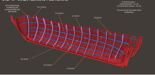

The Upper deck Spirketting Is what the deck planking goes into on the side of the ship

The jig fixtures to locate the position of the deck clamps, limbers and such is ingenious. Maybe it has been around for some time, but a first for me and it will be remembered.
When you use 3-4 at a time to locate and mark clamps they come out virtually exact as to position. All my beams came out pretty much exactly. level.
Ingenious and simple.
All the volumes I’ve collected, never seen this approach.

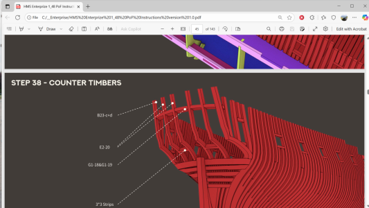

Hi Guys
just starting the stern frames
Does say anything about B23 d (the short one) is t glued to B23c and faired in)If so inside B23c
Also at what height is the cross member G1 18 & G1 19
The instructions really are not good

Hi Guys

Short piece goes outside, ultimately faired when you build door and support frames and then faired.
The G18/19 is a lamination which I wasn't crazy about, built another from stock.
If you jump to 114-116 you’ll get a sense of placement, especially if you trial fit the large transom sheet to size everything up.
Strongly suggest you consider drilling out and pinning the bottoms onto the top of transom.
Also, you should make constant reference to Victors build of the prototype, while there are changes vs the kit it remains quite useful.

THATS GREAT - thanks
Not sure what number the lower cross member is
no number for it
