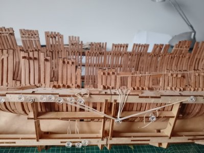

Fitted Keelson decide i wanted to get it to look right so drilled a seriews of holes
Used them to attach the keel but waiting for some copper wire to look the part
The Jig for the inner PLanking is not fully cut so cutting that out and preparing inner planking to see how much of the inner frames needs trimming
Photos follow

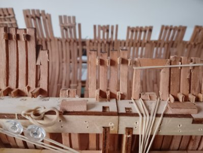

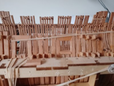

Ive been having great difficulty in getting the measurements of the gun ports in the correct place
But decided the one thing that is consistent is the top og the jig
Its also easier to measure a few cms than from keel
So ive marked the top of the jig on my Plan
Did Gun Port 5 First yesterday and it came out well
Had to remove the aft Fames as it was too wide and stopped the gun port being the right width
Use Geoff's helpful hint of using a head gun to warm the join and it came out

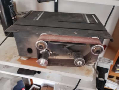

Using my Belt sander trimming this down was far easier than thought

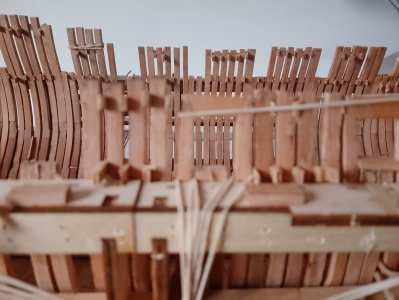

Put In place Marked the UPPER gun port section
REmove Both and cut to shape
Reglued in Frame with upper gun port section
Allowed this to dray and then cut and glued the lower Gun Port Section into place
I then use my finger sander to remove top of frames NEAR the top of the GunPOrts
