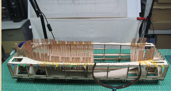

I'm still working on some other things that need to get done but I think I've got a solution to the cant frames that I've looked at. Wife's birthday is tomorrow, so I'll have to wait until after the weekend to try to make some progress on it.

As far as the cant frames, the angle on the bottom of the frame doesn't line up with the keel to glue it. I have to spend time on each one to determine if I can sand it down to the right angle or if I need to add material to the bottom of the frame so I don't make it too short. :) To give you an idea the first cant frame (X1) when the bottom touched the bottom of the keel while in the building jig, I had about a 1/8" (about 3 mm) gap at the top of the keel. On that one, I had some excess material so the top of the frame stuck up above where it should and I was able to sand it. I hope they all turn out like that. :)

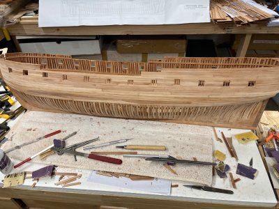

Anyway, here’s where I am. Light first sanding but more needed.
My first semi complaint about the kit, I wished all the exterior planking had been more uniform as to color.
Now trying to decide whether I might apply a light stain to even it up before final finish.
