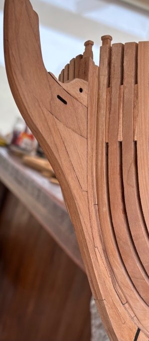

Good morning.
Cutting gunports: Hmmmm……:mad:.
Through out this build the instructions and design of the kit have made this a fairly complex build. So far the challenges have been rather enjoyable and made for some brainstorming - always fun.
Gunports…..hmmm ROTF.

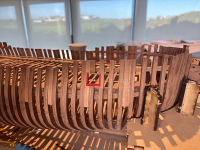

Firstly the two diagrams provided differ from each other so I decided to go with the one which showed the “end product”. The second diagram.
Unfortunately the frames in this diagram are not in sync with my ship so I cannot trust this either and “tossed” it.

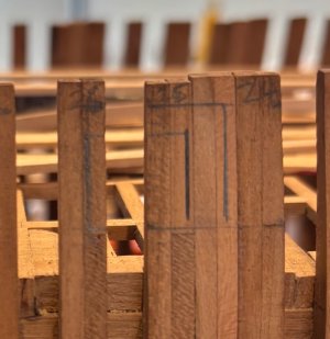

The instructions use a dummy cannon jig which you use to mark the frames as a starting point. I marked each port using this method and using blocks of wood cut to size determined the size and position of the port.

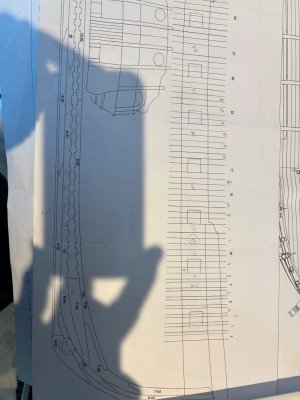

As a double check I used The first diagram which frames do match up 100% to my ship. I cut this and stuck it to the ship.
The really cool thing is my decks and clamps match up to this diagram really well so that made me happy. I Marked each port.
The ports per the plan and my calculations using the jig and measurements came out pretty close but not 100%. Obviously I need to include the stops, lintel and sills so the measured drawing is bigger than the one marked from the plan. Here are two examples:
2 differents methods 2 different results, two different diagrams, two different results……hmmm:mad:.
I then thought I had better check if I can add my spirketling.
Works OK, but the kit is clearly not designed to take this and does not fit super cool with the port.Not glued just a look see.
I cut the first port on SB side using a best guess methodROTF and added some stops, fake sill and lintel. (Not cut correctly or glued) just to see shape and colour.
I now need to try and get the measurements and placement right. For the 10th time:oops:.
I will be showing one or two ports open. For these I will adjust the frames and add a proper lintel and sill as per this diagram:
For all the ports with port lids I will use fake stops, lintels etc and plank according to this diagram:
For those without port lids, I will extend the stops to the plank level as the stops are not required- clearly. …..
Whew that took a while….ROTFROTF.
Cheers Grant

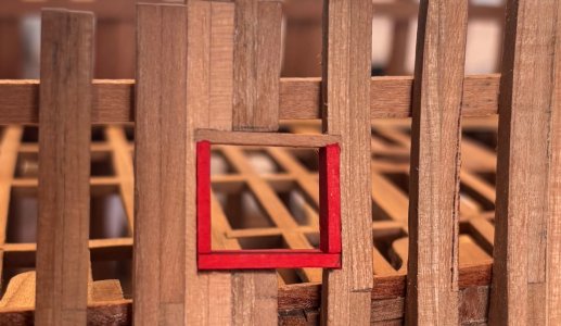

View attachment 522592View attachment 522593

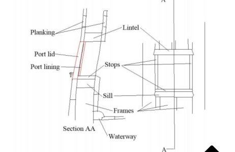

Cheers Grant
