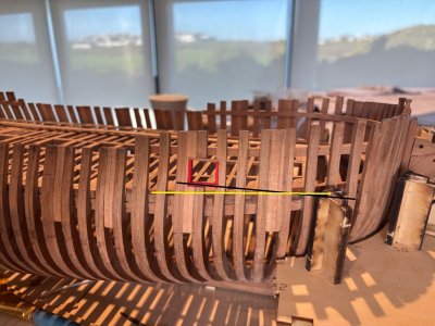

Hi Sasha. From my reading I have not seen ports only follow the deck sheer. I may be totally incorrect here with my understanding. With this kit it has been extremely difficult to any make adjustments to the original design (has been one of my frustrations) so I have followed their gun port lay out, which makes them at 90 degrees to the frame other than the cant frame port. This photo does accentuate the issue tho. I have also measure the ports from the deck using the jig the manufacturers provided which does correlate to the cut outs. The ports end up very close to the deck so it all seems a bit strange.Grant, hi.
I don't want to seem boring, but the port lines and the deck lines should be parallel. In your photo, this is not the case. And also - the gun port frame is always square. Along the frames, it is vertical without changes, and along the deck at the bottom and top. Therefore, in some places it looks more like a trapezoid. And also - for marking the ports, you can use not a template, but the distance from the deck flooring to the lower edge of the port. It is strictly regulated for each caliber of guns. as well as the car and the size of the port in the light. You can use this data for marking the ports

If this is the case my ports will wrong...I cant change them now. I clearly misunderstood what I have read. Maybe help me out- do the wales follow the deck sheer or not ? I know they do not follow the waterline which is the verticle. Whew......In any case, the lower edge of the port should be parallel to the deck.
