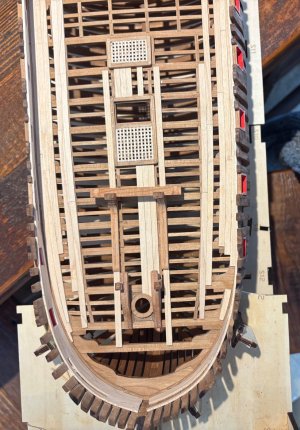

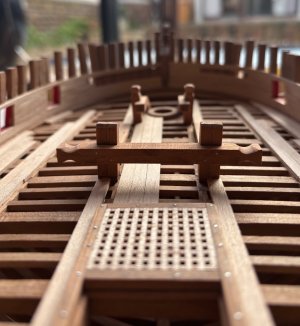

Decided to make some gratings. The kit gratings are difficult to get reasonable as they are very fragile and thin. All the other builds I see the other guys buying or using alternatives…..but I’m a stubborn South African so gave it a goROTF. (Real reason it is a costly mission to get the parts to Melkbosstrand).
View attachment 532044View attachment 532045
Something I picked up a little late is the 3x3mm wood provided varies in size considerably.
My attempts: View attachment 532047
You will see I am leaving some completely open showing the frame/coming and rabbets. I made all sides with a rabbet as I have to lift all fittings by 1.5mm as I am attaching these to the beams directly and going to build the deck afterwards. This is opposite to the kit design.
View attachment 532048View attachment 532049
I have cut a few deck pieces to see how it will look with some pieces missing……nothing glued just trying to see if this design is going to work or am I heading into a world of failure………. We are going to find out sooner or later.
I am struggling to get my finishes to the level I want. I used steel wool to polish, but this changes the colour. I have bought some dremel bits for cleaning and polish so will try these when they get here.
Cheers Grant
Nice gratings and frames with nails, Grant.
Grant! Glad to see you're back at it! Lovely scale model eye-candy! Also, like pornography, I know excellence when I see it. That is some super tight craftsmanship on your gratings, sir!
Finally, since I see who is saying that your work is superlative, which it is, true story! - I know not to believe them when they post the same language in my log ROTF
Speedy progress on your rehab and your build! Keep producing the magnificent eye-candy!
Blessings. Peace. Gratitude.
Chuck
Good evening Chuck. Hopefully it will come together as it is very bitty at the moment.Thank you for your kind words of encouragement I really do appreciate it. Cheers Grant
Really beautiful job on those hatches Grant. As I glanced at your first photo in that post I thought “oh no, his new knee is rusting already” ROTF.
Wishing you a speedy and successful recovery.
Hi Roger. Thankfully not although some days it feels a little rusty ROTF. Thanks for the compliment. Cheers Grant

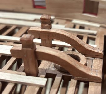

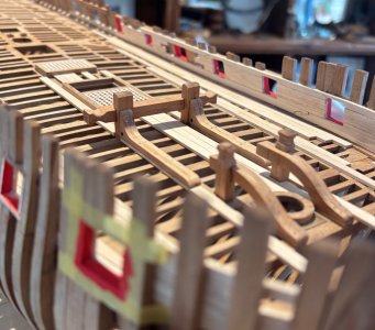

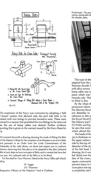

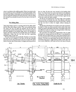

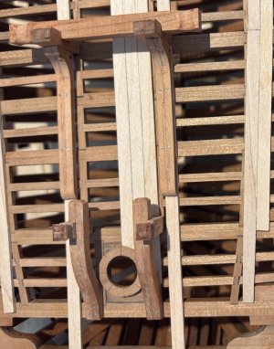

Anyway here are the 2 riding bits. I have modified the kit bits to get close to Goodwins interpretation. Here are pics from Goodwin:

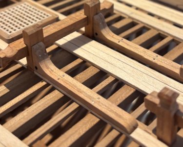

And my attempts at modifying the parts. You will notice the 1.5mm added to the bottom of the bits which I will still plank around some aspects. I had to do this to keep the scale right as the kit just adds parts to the deck.
Trying to work out the deck pattern while leaving off planks haphazardly is interesting……I can guarantee I have screwed this up ROTFROTF. Hopefully it will not be noticeable as I move forward.
Cheers Grant
View attachment 532519View attachment 532520View attachment 532521View attachment 532522View attachment 532523View attachment 532524

How long is your guarantee of screwing valid, when your hope is fulfilled and it is no longer noticeable?
You have already found several solutions, so I am confident that it will work out. I will not be making a claim under the guarantee you offered, Grant.:)
Good morning Peter. I’m this instance I think you may claim successfully. It will work out as I am leaving a lot of the deck open to see the beams,carlings etc so unless you are a Scandinavian engineer you will not pick this up, but I definitely have lost the pattern.:oops:
