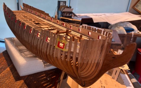

Glad to see you back in the fold :) Great job on having the quick work planking on the bulwarks covering the sills and frames at the ports.
Thanks Allan. I hope it is right to do so. I have taken the cue from some other builders whom I admire.

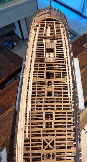

Good morning Jeff. With this build I have had sooooo many redo's I don't think I could hurry. ROTF The next one coming is to remove the kit designed deck clamps at the quarter deck and stern. I don't like the way these are presented and will be changing this.

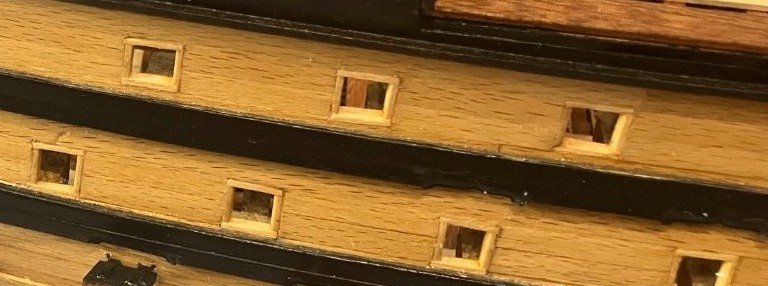

Absolutely. Inboard the sills and also the edge of the linings (stops) end flush with the inboard side of the frames rather than being recessed,and all are covered with the quickwork. Outboard the three linings in each port are recessed and the edges exposed so they can do their job. I am pretty sure ports framing was never done like the photo below, inboard or outboard, on English ships of war in the 17th -19th centuries.

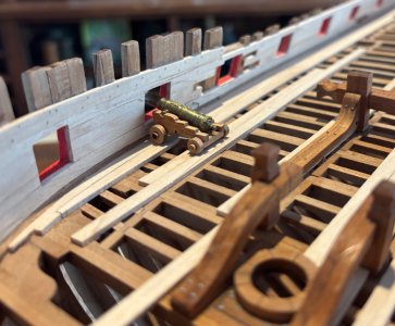

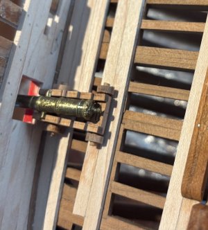

Anyway my Enterprise. Many many hours this week with what appears to be no result. Some more bulkwalk and deck planking and trimming and cleaning gunports. Still no where near finished but thought I need to let you guys know I’m still alive and playing on my ship.
I also partially built a cannon to check the fit- was all good in each port.:D

Thank you kindly Bryian. I have found this kit very challenging especially the measurements of the decks and the construction design of the transom and counters. Non the less I have enjoyed it so far and as always end up doing my own thing. Cheers Grant
