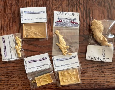

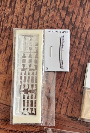

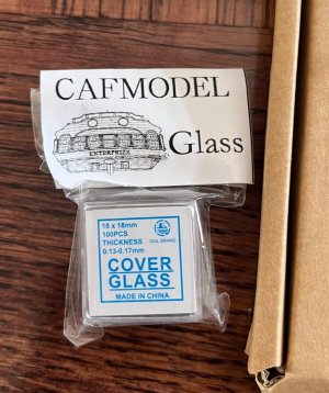

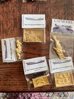

I thought I would start a log for my Enterprise build. I bought the CAF models 1:48 kit made primarily from Cherry wood.
I am impressed with the quality of the kit with everything packed and presented very professionally. Let the photos do the talking :
8FCDDCA8-C162-4578-A13D-ADE076A476C0.jpegA9559685-76BD-43D5-99E2-480EB5563E49.jpegA1CFE1E9-751C-458F-B3F7-E8FB9CDC4A57.jpeg0FE52C54-051B-4CA4-A821-AF2A1686AA10.jpeg903FA6E7-FC9F-4FA8-BC12-541BF241D0DE.jpeg9B43C308-C7F2-45C9-AEC1-E15CBE8FDBDE.jpeg288CF9C8-C08C-4F02-A930-6DDCB4A4AF1B.jpegEC36DA79-ABF4-4147-B794-0E3F4A0B5AF5.jpegBBCF3B4A-3460-4728-9178-5AE0F95119E9.jpeg244FDAD6-2E6A-4997-ADA6-E66433E0C34A.jpeg7E4DF78C-C082-4D2B-B0B1-A4780C12495B.jpeg3480D726-1F31-4B2F-83A7-8B08BB2D1906.jpegAC45687A-1791-4E0F-9D2D-D0F1E54249BB.jpeg
The instructions are just a series of drawings with a 1:1 scale diagram supplied with each section/box. These appear to be really good-the proof will be in the pudding so to speak.
Each box is a section with the instruction manual divided into 6 sections:
986E1373-C617-4CCF-986B-C0687F56E422.jpegCCC37369-3C39-4234-A043-D46C6BB9EC0E.jpegD0B9F791-1206-4A76-9303-CAC20BA8E4A4.jpeg76CF4E96-1F2A-475B-88D9-52F9646EC7F2.jpeg
My initial disappointment is the level of accuracy with this kit. Just some background reading and my preview of the kit has revealed a fair amount of discrepancies. Being my first POF I am inclined to “stick with the kit” however we never know….;).
