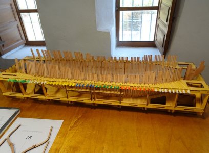

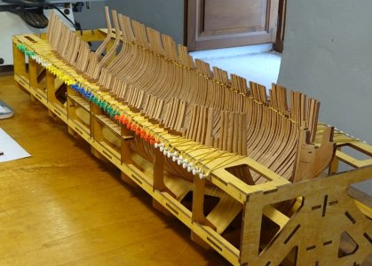

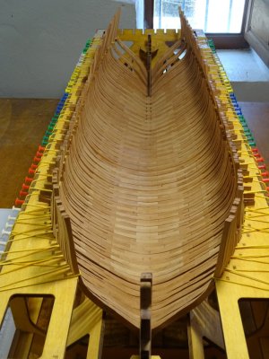

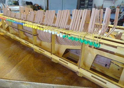

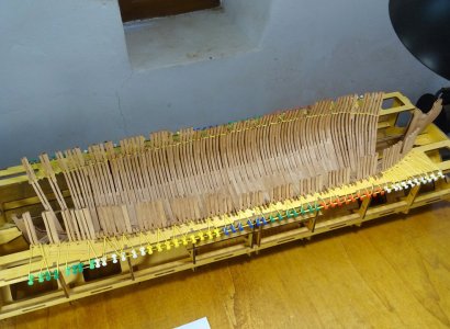

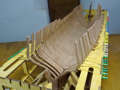

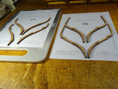

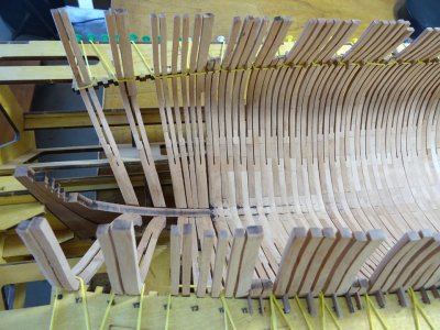

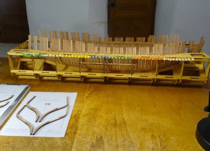

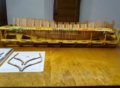

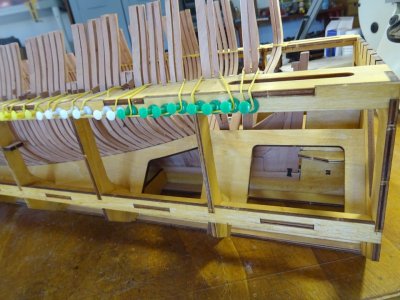

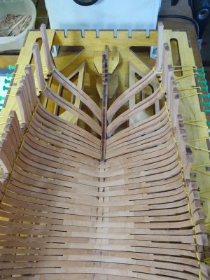

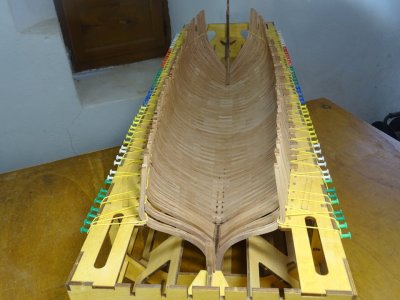

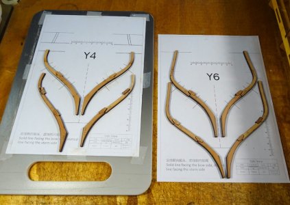

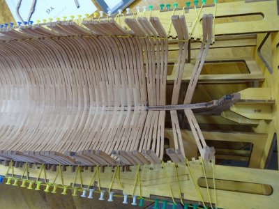

It's very nice to see your very accurate build of new frames, Keith. With the special shape of the ones in de bow and stern.Hi All. Back to my build log . . . I have now finally glued the frames 1 to 37 permanently onto the keel. Nice and rigid. And also made a start on the stern cant frames. These frames require a different method of construction to the ''straight frames'', and some working out and attention to detail is needed. The odd number frames, y1, y3, y5 and y7 are what l shall call double frames, ie the A and B sides are made up and are joined together at the floor timber and are sanded as one piece, like the straight frames. Frames y2, y4, y6 and y8 are made up as individual A and B sides because they are not actually joined together at the floor timber section. They are fitted to the keel individually although they are one frame, if you follow what l mean. Because of this great care must be taken to make sure the step in the futtock joints is in the right direction. A bit of lateral thinking is required. A bit tricky for my little brain

You really have to keep your mind on what you're doing with this one, especially when it comes to the cantsIt's getting better.I just posted an update in my thread.
I tried to do some work on some frames when I wasn't feeling that great and now I have to take a few apart.
I guess that is to be expected when you can't really focus on what you are doing. I messed up some of the futtock shifts.![]()
THANKS PAUL, Really appreciate the commentsKeen attention to detail, Keef! Bravo! She's quite an impressive model in your hands.
Thank you Peter. I really appreciate your commentsIt's very nice to see your very accurate build of new frames, Keith. With the special shape of the ones in de bow and stern.
And I want to wish you a Happy Birthday, Keith. Enjoy this day!Thank you Peter. I really appreciate your comments
