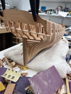

My shaping/sanding is coming along. Started back at it since I returned from Montana.
All the sanding is pretty tedious so I tackled some fitting to the transom to see if the transition from the hull flowed reasonably well.
All the counter timbers were glued up/pinned with bamboo pins and spaced out according to the dry fit transom piece with windows and everything seems to fit reasonably well and seems symmetrical so I'll finish framing and doorway next then back to finish sanding.....probably go down to 600 grit.
That's about it for now and thanks to Jeff for allowing me to jump on
That's about it for now and thanks to Jeff for allowing me to jump on here together with his fine work.
Tim

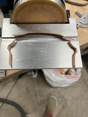

If I may interrupt the framing progression one last time….a continuation of above photo.
As stated to finalize framing process, it lead me to installing counter timbers, last framing/ doorway etc. and simply dry fitting transom after I scratch built the trim piece which locates beneath it ( it is not supplied in the kit).
This lead to some confusion, about all the side/top trim pieces that surround three sides of the transom.
After some head scratching I decided I was not going to undertake all of the heating/bending required to get, what are flat pieces, to fit all those complex curves so I fired up the scroll saw and cut out three pieces, easily traced out using the transom as a form.
Be aware, because the transom fits the timbers on a curve, if you find this approach useful you need to cut the top piece quite wide and then trim it to proper width representing the curve and flow of the transom.
These parts are fresh off the saw and need sanding, final shaping, fitting but I think it’s a decent start.

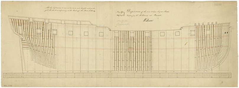

Ivs built half of the FRames
So decided to clean some up (Inner cleaned of chaff and nice and flat)
Joined a couple together
On Blandford the top of the Frames had fillers
Was this correct - Cant find any reference to them in Anatomy of Ship Blandford so I presume its not correct
thanks
There are no fillers supplied with this kit
