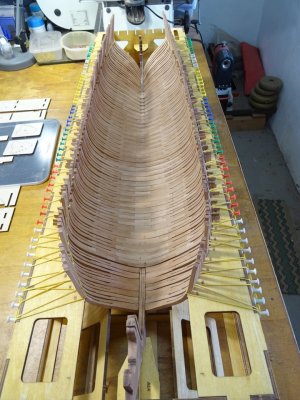

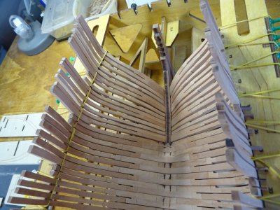

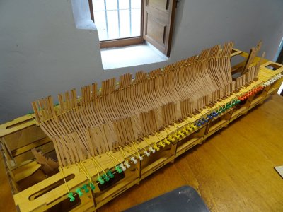

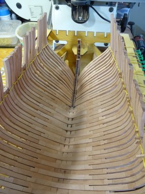

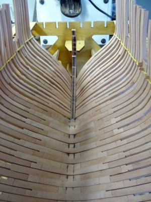

Hi All. Back to my build log . . . I have now finally glued the frames 1 to 37 permanently onto the keel. Nice and rigid. And also made a start on the stern cant frames. These frames require a different method of construction to the ''straight frames'', and some working out and attention to detail is needed. The odd number frames, y1, y3, y5 and y7 are what l shall call double frames, ie the A and B sides are made up and are joined together at the floor timber and are sanded as one piece, like the straight frames. Frames y2, y4, y6 and y8 are made up as individual A and B sides because they are not actually joined together at the floor timber section. They are fitted to the keel individually although they are one frame, if you follow what l mean. Because of this great care must be taken to make sure the step in the futtock joints is in the right direction. A bit of lateral thinking is required. A bit tricky for my little brain :)

I wanted to check my Keel and stern and Built Y8 its joined together all the way up
Looks correct in Instructions as it hold most of the stern together
Have you done Y8 yet
I also notice that on another blog that the back part of the keel is 10 Foot rather than 12 most of the way
It Looks like the Futtock Step on these Frames is towards the Bow
Is this your understanding !
I posted a question on your Post as it was for you
Did you find the final Keel length was too long ?

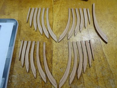

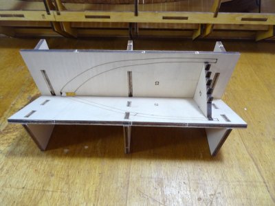

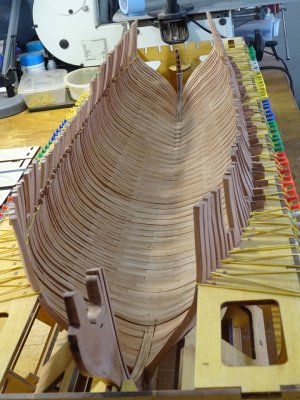

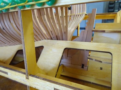

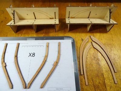

All frames are now complete, except cant frames x8 and y8. Iam now looking at the hawse pieces as this is the next stage. The jig used for the construction of the hawse pieces is shown . I have begun making up the jig. It looks simple, but l have found it to be a real pig to put together. More on this later

I go by the frame plans for the futtock step direction. They go both ways. There must be a reason for the pattern but I've not worked that out yet. The keel length on my build is about 3 mm longer than the position of the stern post but everything fits the drawing and it all fits into the jig. And all the frames fit exactly as they should

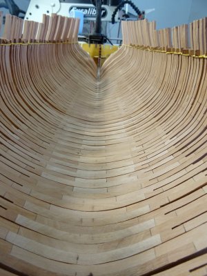

The more photos you post of this kit, the more impressive this looks. The quality and accuracy looks to be light years ahead of the old guard kit manufacturers.
You're absolutely right Allan. The standard of materials, the accuracy of the fit and engineering that has gone into the production of this kit is incredible. I have nothing buy praise for Modelship Dockyard and this amazing kit

Thanks very much Grant, and thanks for the birthday wishes. Too many of them though :) . I've sorted the jigs now, so will detail the construction process of the hawse pieces in a couple of days. Cheers mate

Th main frames look amazing

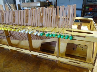

I see youve put spacers just above your rubber bands
The frames appear to be close around the gun ports

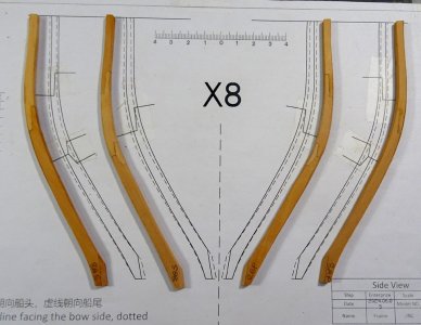

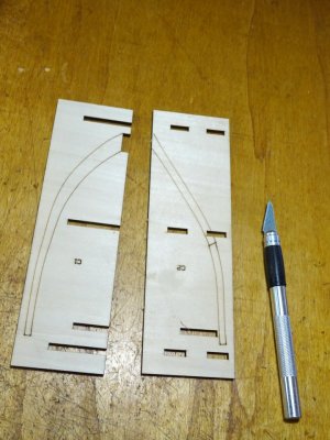

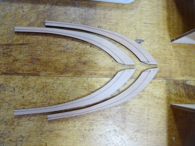

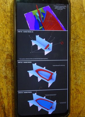

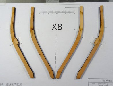

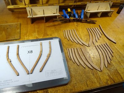

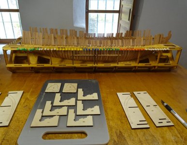

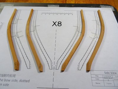

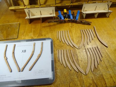

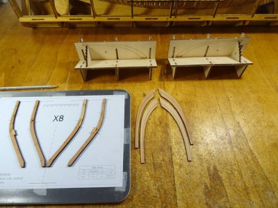

I have not seen anywhere written details of the building process for the hawse pieces for this kit, so l will give my interpretation of how l think it should be done over the next few days, going by the 3D drawings in the pdf manual. I hope it will work out OK, but only time will tell. I have started by making the 2 jigs supplied with the kit which support and accurately place the parts during the building process. The parts making up the jig are a really tight fit so a little cleaning of the char is necessary in all the joints. The next step is dentifying the components, and making up the last of the bow cant frames, x8A and B. The hawse pieces adjoin to x8A. The hawse pieces themselves consist of 28 seperate parts (F1 to F7) that join together making 7 port and 7 starboard frames as shown in the photos . The weather here, over the last week or so has been extremely hot, 37 deg C outside and 31 in my workshop, so am calling it a day for now. I shall continue over the next few days detailing the process as l understand it, so until the next time . . .
