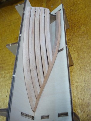

The hawse port and starboard are nearly complete, with 1mm spacers placed between the frames. Not having any reference, I'm not sure if this is correct, but they give some much needed support so have gone ahead with it. They will be planked over so will not be visible anyway. The shaping of the frames are pretty obvious, until you get to the last 2, frames 6 and 7, where they do take some thought and working out. Unfortunately, I have made an error with the shaping of the stbd. frame 6 and 7 and they are damaged beyond repair. I have notified Victor at Modelship Dockyard for replacement parts and although being extremely busy, has replied and offered to send the parts free of charge. This after sales service is excellent. Thank you Victor Zhing

Nice work, Keith. And a great service from Victor.
Nice work Keith - these timbers are really tough to get right. Ive done mine over on La Renommee several times and still need to re work the port side before finally being ready to install them

Hello Keith,
I only discovered this build this morning. Amazing workmanship! You noted that you made a mistake on stbd. frame 6 and 7. Could you please be more specific? I am learning much from your build and from @AllanKP69 who seems to be a wealth of knowledge on how ships were actually built.
Thank you very much. The 7 frames that make up the hawse, port and stbd are each made up of two halves glued together, with sanding lines etched on both sides which form the curve for the inner and outer face of each frame. The first 5 frames are obvious as to which side to sand to, but frames 6 and 7, because of the direction the curve of the bow are much less obvious and I sanded 2 of these frames in the wrong direction. This is quite a complicated part of the build and it only takes one slip up to ruin the frame
