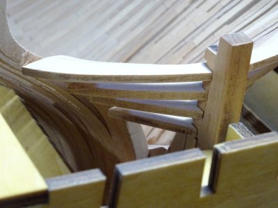

This framing is more like on Admiralty models than the actual ships so go with whatever works best. Even on the actual ships there were spacers at times, and the size of the spacers varied all over the place even on the same ship as the frames were set up to form the gun ports. Below example is Vengeance 1774. You can see the pieces between frames varies a lot as the siding of the frames varies from the floors to the top timbers. These spacers are only on the station lines but I have no idea why.

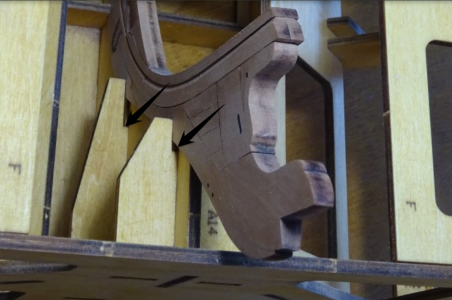

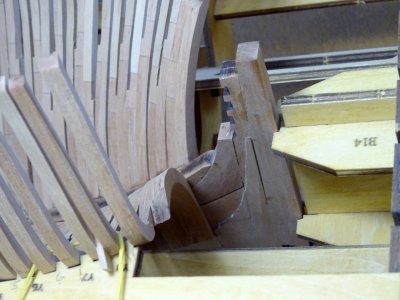

On the diagramComing along with the construction of the hawse pieces. x8A and B have been faired. x8B is in its position on the keel, while x8A is placed in the jig for the hawse pieces as all the frames will attach to it. The first piece, F1 is sanded to shape, inside and out. This is the piece that attaches vertically to the hull and is the longest of the 7 frames making up the hawse pieces. It is dry fitted to the cant frame x8A and fits very nicely. F2 is also sanded to shape and takes up its position in the jig next to F1. I must be doing something right as it fits on x8A and the shape forming is instantly recognizable. All good so far
On the diagram HAWSE PIECES it says "Attaching to surface Y8" I presume it means X8B !Coming along with the construction of the hawse pieces. x8A and B have been faired. x8B is in its position on the keel, while x8A is placed in the jig for the hawse pieces as all the frames will attach to it. The first piece, F1 is sanded to shape, inside and out. This is the piece that attaches vertically to the hull and is the longest of the 7 frames making up the hawse pieces. It is dry fitted to the cant frame x8A and fits very nicely. F2 is also sanded to shape and takes up its position in the jig next to F1. I must be doing something right as it fits on x8A and the shape forming is instantly recognizable. All good so far

On the diagram
On the diagram HAWSE PIECES it says "Attaching to surface Y8" I presume it means X8A !
No. x8A is correct. x8B is on the stern side as it is with all the frames. y8 is for the stern can't framesThat is brilliant - Thanks
On the diagram
The instruction quote Y8No. x8A is correct. x8B is on the stern side as it is with all the frames. y8 is for the stern can't frames
My instructions don't say anything about y8The instruction quote Y8
THats what i Mean Its Wrong
its on the Printed White Page Hawse Pieces Bottom Left - Attach to Y8 !!My instructions don't say anything about y8

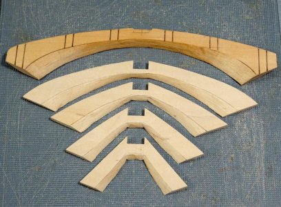

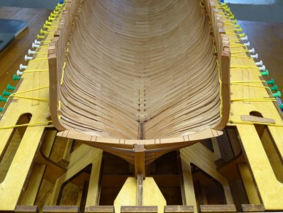

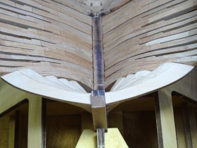

Looking good Keith- nice oneAll the hull frames are complete and permanently fixed onto the keel, making a complete hull, except for the hawse piece assemblies, port and stbd., which are still awaiting my small repair work-in-progress. In the meantime, I have moved on to the transom. The 5 pieces are shown after sanding to shape. They attach to frame y8B and the stern post. A bit of fine tuning is involved in getting them to fit and they are very awkward to get at whilst in the jig but worked out OK in the end. btw. Almost forgot. Be aware, to achieve the angle for the cant frame y8, you must ignore the sanding line lasered onto the floor timber of y8A. This looks to be a manufacturing error
It’s always a complex part of the hull, Keith. It’s looking very nice.All the hull frames are complete and permanently fixed onto the keel, making a complete hull, except for the hawse piece assemblies, port and stbd., which are still awaiting my small repair work-in-progress. In the meantime, I have moved on to the transom. The 5 pieces are shown after sanding to shape. They attach to frame y8B and the stern post. A bit of fine tuning is involved in getting them to fit and they are very awkward to get at whilst in the jig but worked out OK in the end. btw. Almost forgot. Be aware, to achieve the angle for the cant frame y8, you must ignore the sanding line lasered onto the floor timber of y8A. This looks to be a manufacturing error
Thanks Peter. It sure is difficultIt’s always a complex part of the hull, Keith. It’s looking very nice.

That´s another way of doing itKeith,
Looks like they turned out nice.
When I did mine, for others reference, I did them absent the last couple cant frames to get the ends to butt up against frame as evenly as I could………a bit less fidgety.
Tim

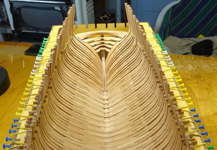

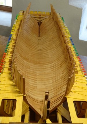

just rechecking what you have done so farThanks very much Jeff. I am indeed counting this as a mile stone in the construction of this build. Everything fits so nicely in a tribute to the design and manufacture of this kit. Excellent job Modelship Dockyard!! The next step is the construction of the cant frames x1 to 8 (bow) and y1 to 8 (stern). Although first I think I shall glue all the these frames to the keel. A little daunting as this would then be permanent, but it has to be done at some point.

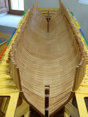

A couple of questions about this so farNow all the midship frames are complete (1 to 37), these are the frames attached to the keel at 90 degrees, the next thing is to concentrate on the cant frames (x1 to x8 at the bow and y1 to y8 at the stern). They are set at an angle to the keel hence the name cant frames and require an entirely different approach. Unlike the 'straight' frames which are one piece made up of an A and B side, these are 2 separate units of A and B glued either side of the bow or stern deadwood. Also, to make things even more complicated, every other (the even numbered units) are not glued together at the floor timbers, but the A and B sides are to be treated as separate, i.e. not glued together. Each set of frames sit in the support notches either side of the deadwood which were made when the keel was first constructed. Attention must be taken to get the angle correct where the frames join the keel. This angle gets steeper the closer to the bow (or stern). So far all frames are dry fitted. A little fine tuning will be necessary when it comes to gluing everything permanently into place.

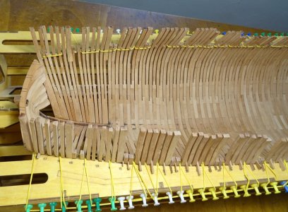

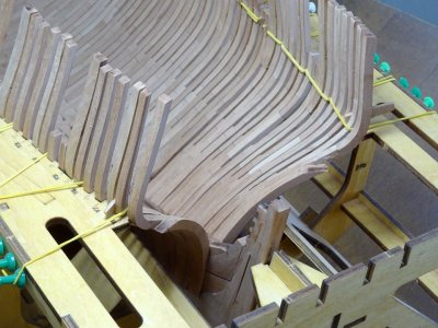

Getting Close to this stage This is incredible work from you !!Have now completed the fore cant frames (x1 to x7). There is actually an x8 but I am leaving that for the time being as x8A is used to make up the hawse pieces and is not fitted into the hull until that part is complete. Everything is still only dry fit and some work is required on the cant frame bases where they join the hull as some of the angles are not quite right. Not too bad but could be better. So, I think next I shall permanently fix the frames 1 to 37 to the hull, the concentrate on the stern cants
Thanks Richard. Good I can be of some help. No problems with the frames at all. They all fit exactly as they should. When you get to the cant frames take great care to get the angles right where they meet the deadwoodjust rechecking what you have done so far

I did put temp separators in between the frames but like the idea of them all being at the same level and sticking out
Did you find any problems after you had glued these frames in ?
