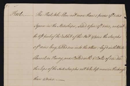

For a 28 gun frigate the keel should have 14‘‘, as for HMS Triton. 12‘‘ is the value for Fly and other sloops.
From the contract for 28 gun frigate Enterprize 1774 Aurora, 1776, Fox 1773, et al
The Keel to be Elm, not more than 4 pieces 13½ ins square in Mids, sided afore 12 ins, & at the aft part of the rabbet of the post 10 ins. The Scarphs 3 ft 8 ins long, tabled one into the other, laid with white Flannel oakum bolted with Six Bolts 1 in diameter. The lips of the said scarphs not to be left more than 3⅞ in thick.
From the contract for Lowestoffe, (32) 1761. Obviously larger than a 28 but the variation in the siding of the keel is pretty clearly shown.

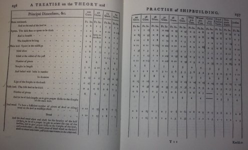

From The Shipbuilder's Repository 1788. the keel for a 28 gun frigate was 1' 1 1/2" square midships but reduced fore and aft. One oddity to me is that the siding is the same or smaller aft compared to at the stem for all sizes of ship except for a 28. I wonder if the numbers were transposed. The scantlings increased by the end of the century and shown in the folios of Steel's The Elements and Practice of Naval Architecture 1805.

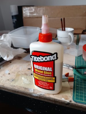

I have used Titebond exclusively and found it to be perfect. I leave all frame joints overnight to dry. Are you over sanding the joints. They only need a slight sanding to clean the char, or you run the risk of changing the shape of the pieces and they wont fit tightly

Which Titebond glue are you using? there are several types, even a CA glue (or what is often called superglue).
