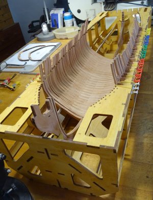

Not all the same. There are 37 frames and another 16 cant frames. The frame numbers from 1 to about 12 provide a taper to the hull so they are a different shape with different tapers. Then again starting at about 24 through 37 also has a different shape because you are getting more of the V at the bottom near the stern as you get closer to the rudder.
I hope that helps. :)

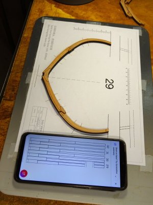

I have changed the method of making up the frames on the drawing sheet. I now just put a piece of sticky tape over the areas where the joints are, i.e. the chocks and make the frame directly over the drawing. When the glue is dry it lifts straight off without damaging the original so it can be used for both A and B side. No need to copy the original sheets. Works a treat
Sorry what i mean is Photocopy it ie EACH Plan Mens you dont damage the original or need cling film
Although i presume cling film stops the glue/frame stickeng to the Plan
On each drawing, just stick a small strip of tape over each place where there is a joint, chock or scarf joint. The glue will not stick to the drawing and you can reuse the same drawing for both A and B sides without the need to copy the originals

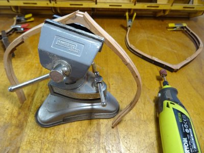

I use a hand held spindle sander for fairing inside and out. Wouldn't use anything else
Like the idea of a hand help Spindle sander can you post a photos

This is the tool I have found to be the best for sanding and fairing the frames. Use 120 grit sanding tubes as they are not too course and use very gentle pressure as you sand in one direction only (against the direction of rotation of the drum). Make sure to have plenty of spare sanding tubes as they wear down pretty quick. Maybe about 4 to 5 frames, inside and out, per tube
