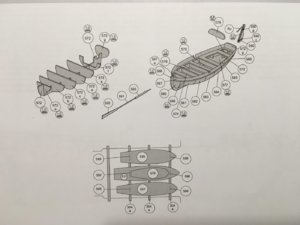

I’m starting my first my paper ship this morning and my first build thread on this forum. The kit came on a bunch of large sheets of different weights. Some have to be glued to .5mm or 1mm cardstock. I’m scanning in each sheet then I’ll print them on the appropriate thickness of paper. That way if I screw up a part I’ll have a backup. If I do this right, I’ll still have all the original sheets completely uncut. A new kit still! That’s one of the benefits of paper. I plan on using very thin wood veneer for the decking and any other place where actual wood is visible. I’ll use paper of various thicknesses for any parts that get painted. This is truly a mixed media kit. When it’s done I don’t want it to look like a paper kit. I also want to experiment with some mold making and casting for some of the repetitive parts like the cannons, the cradle things that the cannons sit in (I still have a lot to learn about ships, lol), and for some of the fittings that are all over the ship. Today I’m going to start on the little boats. I figured this will be a fun way to ease into this huge project, and they look really cool.
I know I’ll have lots of questions along the way and I appreciate any help I can get. I’m not new to modeling and I’m not new to working with paper, but I am new to ship modeling. I’m going to take this slow and work on one bit at a time. I’m treating this like a bunch of smaller kits so I don’t get overwhelmed and burnt out. Thank you in advance, I know I’ll be bugging you guys!
-George

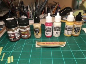

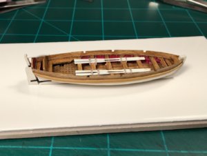

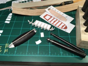

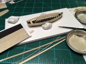

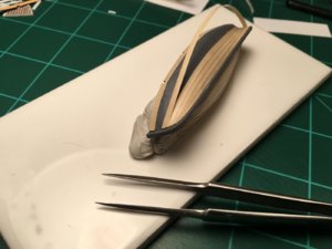

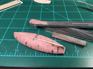

I finished my first paper lifeboat for the 1/96 HMS Enterprize. Only 3 more to go then I gotta build the ship. I’ve greatly strayed from the kit parts and directions since I’ve been influenced by an amazing modeler from the Czech Republic named Doris. She builds the best paper ship models I’ve ever seen, in fact they are among the best of any ship models. Her work can be found on papermodelers.com . Search for Doris. Her Royal Caroline is beyond belief. Her techniques are fairly new to me and I hope to at least be in the ballpark of what she has done.
Here are some photos that hopefully explain how I’ve built this lifeboat.475F614C-E386-4EE2-AE0B-70115BC84ED8.jpegB0622D1D-129A-4E03-BF76-7644834D282A.jpeg64606C5D-EE9E-4322-9F96-E14D9197D680.jpegF5F58891-E634-46C7-9F49-C90E6F631768.jpeg979A8DA8-7541-437E-A7D2-69B3D3B8560F.jpeg96B849EC-C96A-403B-8588-A1EE8D91CB85.jpegFEDBE4ED-A1C1-495C-8E45-5F5DEB34D2F0.jpeg3C33AF6C-98F6-470E-B782-DA79D1DE603B.jpeg238027CF-E061-407D-8837-ECCE77ACB413.jpeg5FD557D9-6B54-455F-9150-2A52FA5EA3B3.jpeg20DD7636-967C-47AC-9374-2D2650E6185D.jpegC0F2005D-B8BE-4AB6-9EBE-047202A61C0C.jpegC4CCABC9-A0B2-4D89-B98F-792DABF0560A.jpeg03451F7A-C14C-4442-ACC3-107A98842990.jpeg274DA75A-2F29-4804-9D34-A8C66679773E.jpeg6DC164C6-A2AF-4E99-A837-BD738F3A12D3.jpeg92B67652-F8D0-4CA9-B3E2-5BB76F1332F2.jpeg0A7F8D4A-626B-4041-B169-D6230DF491BE.jpegA0CFF143-B628-4571-8D0B-E584FA4B7D96.jpeg

I’m using wood colored contact paper from d-c-fix. This is what Doris uses.
