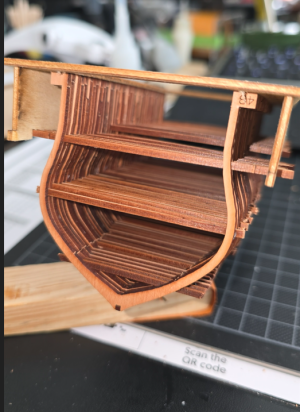

Hey folks,
Now comes another step. Now the individual formers and also the double formers for the gun bays are inserted into the frame. This actually works quite well and you only have to fiddle a little to make the formers fit into the frame. But take a look at the pictures for yourself ...

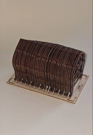

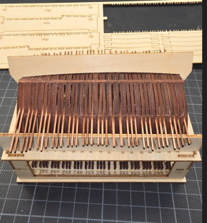

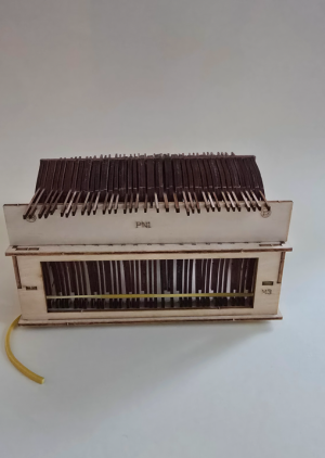

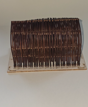

Hey folks,
and on with the construction of the HMS Enterprise in 1/160th scale. Unfortunately, I didn't do a very good job of it. This ended in the loss of 5 frames. They broke because I had applied too much pressure. Thank goodness my glue fixed everything and I was relieved. Nevertheless, fitting the keel was not easy, as many of the frames simply popped out again, leaving me with no keel support.
It was quite a challenge. I hope you like my pictures ... ;)

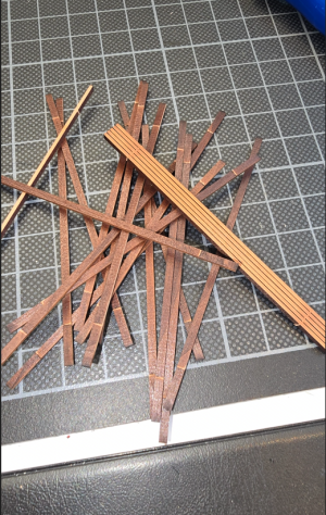

Once the keel was in place, I had to put the first spacers in place. To do this, I had to place a new platform on my structure. That was part PN1.
When the first row of spacers was finished, I took the measurements with the template to check whether the model would still fit for later processing ... And yes, it fits!!!

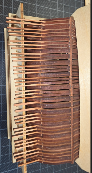

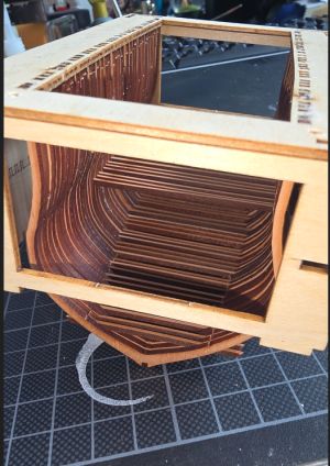

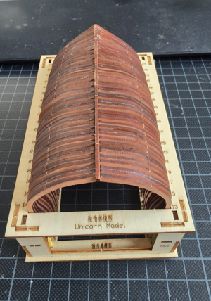

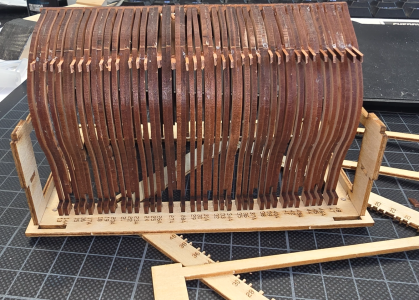

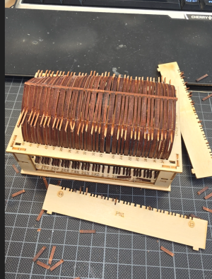

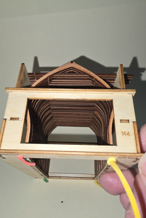

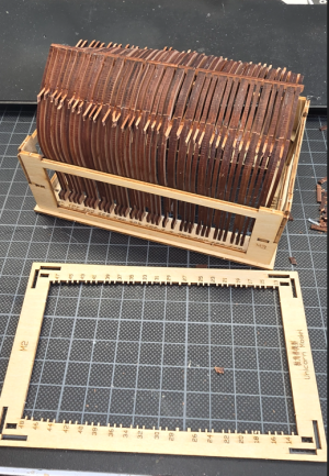

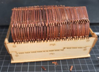

After inserting the first spacers, it was time for rows two and three. To do this, I had to rebuild the body again and remove the PN1 template and insert the PN2 and PN3 templates.

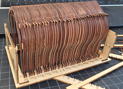

Now I started to install the second row of spacers ... That's a fiddly job ...;)
And that's it. The second row of spacers is now finished.

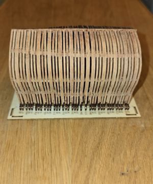

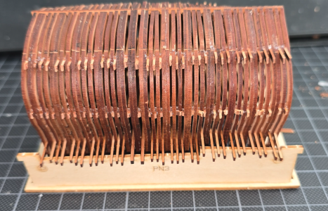

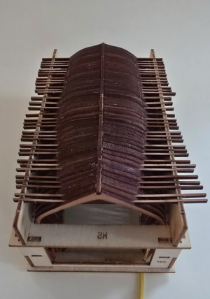

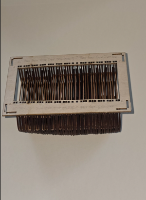

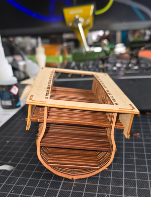

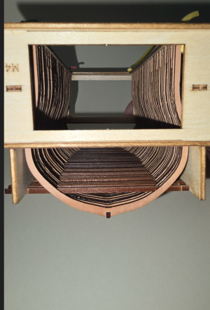

And last but not least, of course, the third row. I then had to remove the structure in order to fit the third row of spacers.

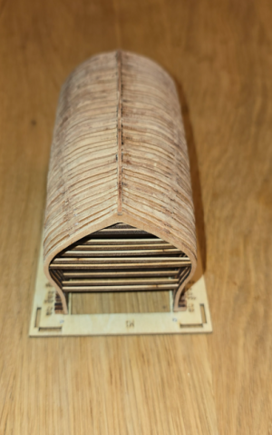

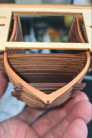

Then, of course, the overhangs had to be sawn off and sanded.

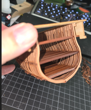

I took some sandpaper and tried to sand it by hand. As I am such a patient person and it just took me too long, I decided to load my Proxxon with 400 grit sandpaper and off I went. Very carefully, of course. When I removed the laser cut marks, this beautiful pear wood came into its own and I was surprised at how beautiful it looked.:DThumbsup

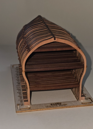

This is what the frames looked like after they had been sanded ...
The sanding had already taken some time and thankfully it went well without any problems or damage.

Coming along nicely. Remember to support the frames on each side when cutting away the gunports. I scored them, a bit oversized, first then filed them to final height.
Hello Richard,
Many thanks for the tip. Did you have any problems cutting out the gun ports? How did you cut them out? With a normal scalpel? Did you break a bulkhead? I don't think the instructions are very good. There is also little description of the dinghies. Have you already finished the dinghies?
I scored them about 1mm too long, drilled a small hole then used a knife. Finished off with files. Support is the main thing, even in boxwood they can split easily.
View attachment 552119 View attachment 552120
Good morning Gunther. Coming along nicely. Have you tried using a scraper rather than sanding all the way? I find the scraper brings out the wood colour and grain (if any) much nicer. This looks like a really cool build. Cheers Grant
View attachment 552106 View attachment 552107
View attachment 552108View attachment 552109
