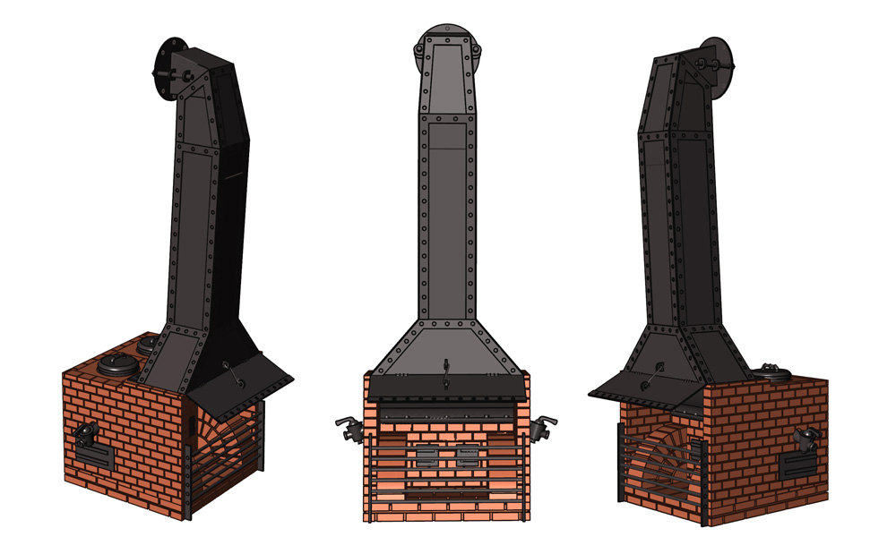

The galley stove looks great Uwe. The brick effect is very realistic. When I saw the stove included with part 2 of the kit I was planning to do something similar when l reached that stage. I just hope I can get anywhere near as good results. I do not like working with PE though
Such beautiful work! I believe the stove's hood and stack are made of brass; what finish did you use to get the metal/pewter finish? It works SO well here.
Hallo,
yes the material is brass - for blackening, or better to say bluening I am using Balistol,
which available here in Europe (unfortunately not in the USA as we discussed once)
You are absolutely right - not the easiest material to work with - but the finla result is not bad at all
BTW: This stove can be ordered from CAF also separately - so if somebody needs a stove in this scale
or another type - close to a Brody
