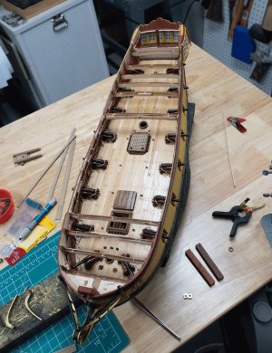

HMS Ontario 1:48 by Maris Stella

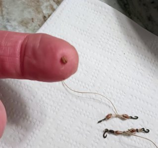

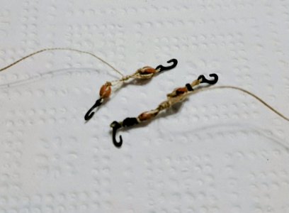

These are nuts to tie, I've made 3, lost 1 on my bench somewhere. Think I'll only make them for the 6 guns on the upper deck and 6 or 8 on the gun deck. It seems a lot of finished models I see only use the thicker recoil lines.?
Thanks
Neil

Hello, I started back on this build. I find the instructions ( for me ) hard to follow so i took a break and did another kit.

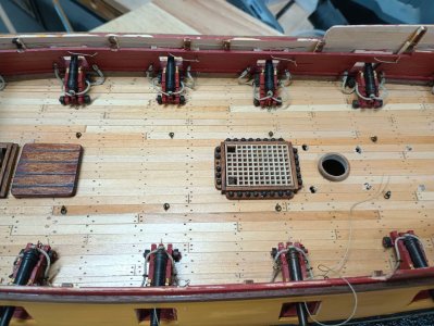

I've mounted the canons on the gun deck with just recoil rigging. Next is to finish the bow head rails, bowsprit and figure out the mounting of the snow mast then I can instal the upper deck.
Neil

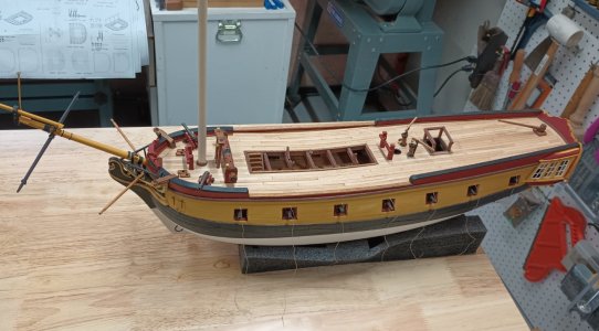

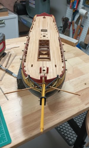

Moving right along I've finished the bow and bowsprit and installed the upper deck.
There are some issues with the height of the bullworks as the port side is higher than the starboard. And I'll have to make sure the bullworks at the bow and stern are the right height for the canons.
