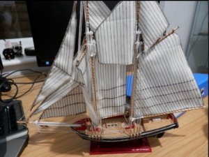

The phrase ‘Boston Fishing Smack’ has stuck in my mind, don’t know why and it is probably not the case; maybe some of you guys know what it actually is. Not only did I enjoy finishing it for Dad, I also enjoyed the woodworking involved, doing the rigging, even sewing the sails!

Hi Graham and welcome, the model you have posted looks like a 'Smack'
the following may be of help. The American built fishing smacks weren't very much different from the English ones, however, judging by the sails on your model I'd say it could be an American version.
A smack was a traditional fishing boat used off the coast of Britain and the Atlantic coast of America for most of the 19th century and, in small numbers, up to the Second World War. Many larger smacks were originally cutter rigged sailing boats until about 1865, when smacks had become so large that cutter main booms were unhandy. The smaller smack retain the gaff cutter rig. The larger smacks were lengthened and re-rigged and new ketch-rigged smacks were built, but boats varied from port to port. Some boats had a topsail on the mizzen mast, while others had a bowsprit carrying a jib.
Large numbers smacks operated in fleets from ports in the UK such as Brixham, Grimsby and Lowestoft as well as at locations along the Thames Estuary. In England the sails were white cotton until a proofing coat was applied, usually after the sail was a few years old. This gave the sails its distinctive red ochre colour, which made them a picturesque sight in large numbers. Smacks were often rebuilt into steam boats in the 1950s.

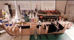

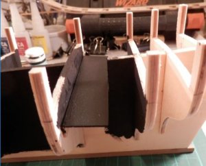

On to the hull itself. I don’t have a keel clamp (it’s on my Christmas list), so I used a couple of ‘L’ shaped brackets bolted through the keel as shown in the photo – should stand me in good stead until I get to planking when I’ll have to remove it. Pretty straightforward assembly and I took care to get the bulkheads square to the keel but later in the build, I noted that a couple was very slightly out in the vertical axis. Learning point 1 in the next build. As previously noted I like to build dioramas, so I’d like to at least put some figures on the deck. Hence, I cut down on the keel beneath the rear-most hatch (see photo) and put a false deck in so I can do something along the lines of a couple of guys loading some cargo. From what I can see the choice of appropriate figures (1:64 scale) is limited, so I guess that’s my first question – does anyone know a source for figures (crew and officers) in a variety of poses or ones I can modify? If it doesn’t come off I’ll just glue the hatch on and nothing is lost. The bulkhead edges were then shaped to allow for the lay of planks and I later found that some of these needed further fettling when I started planking – but better to take too little off than too much, I reckon.

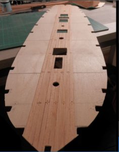

The instructions say to glue the false deck in place prior to fitting the gun-port bulwarks. I don’t really like this idea because that means planking the deck in situ and I want to do it off the model as it will be a lot less fiddly. After much pondering I put the false deck temporarily in place and used it to align the bottom of the gun-port bulwarks and tack glued where the gun-port bulwarks meet the bulkhead frames at the bottom edge only – the top parts of the bulkheads are later removed at deck level in the build and are only there for profile, so you can’t glue to them. It worked OK, the false deck was then removed and I plan to run the first plank beneath the gunport bulwark and glue the two edges together to provide strength.
I shall plank the deck while I wait for my plank bending tool to arrive. I had put it on my Christmas list but the job is stopped without it. The deck is planked with Tanganiyka strip and my first impression was that this is pretty rough stuff, especially along the edges which I tried lightly sanding but to no avail. I hovered on the edge of buying something better but in the end I decided not to – I got this model to learn the skills, so deal with what you have. I wanted to get a planked effect, so had a look online regarding what the scale length would be. Opinion seems to be divided so I settled on 4’’ based solely on the fact that it looks about right to me – I don’t think this will be the biggest thing to worry about during this build and I can hear the rigging plans laughing at me from the cupboard! I scored each strip at 4’’ with the edge of a file then used a 0.5mm drill in a pin vice to make a small hole either side of the score line – all of these marks should(?) take the stain darker. The fore and aft platforms were treated in the same way and I developed a bad case of Pin Vice Driller’s Thumb.
hi Graham, nice progress so far. On my Endeavour I planked the deck in the two halves so that when they go together you cannot tell that there is a join, Popeye prfers to plank his deks in situ and runs a strip straddling the join. Every modeller has his own "technique" which in turn becomes an idea and a way of doing something.

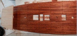

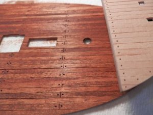

To stain the deck I used a medium teak coloured stain I already had in the garage. There were some areas where the CA glue stopped the stain taking, but a light sanding and re-application of stain did the trick. Then a couple of coats of satin lacquer. I think I’ll leave it as a satin finish even though the instructions suggest a matt finish. The photos below show the fore and aft decks not yet stained – sort of a before & after view.

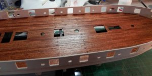

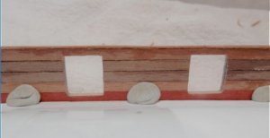

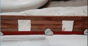

Still working with the deck. The instructions say to snap off the upper protruding parts of the bulkheads with a pair of pliars but having gently tried one it just won’t work – you really would have to apply a lot of heave-ho and risk damaging something. So, I used the circular saw attachment on the Dremel and cut most of the way through and that was better. Now that I have shaped the deck to fit I want to get the inner planking of the gun-port bulwarks fitted to give some rigidity.
I pre-painted the first plank strip and put that in place. I could have then run the planks across the gun ports, but chose to plank individually between because then it is easier to get a knife/file in and I didn’t want to be overly heavy-handed when cleaning the edges up. I guess it takes a bit longer to do the planking, but I’m happy with that method and would do it again. In the rough -
Cleaned up -
Painted -

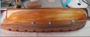

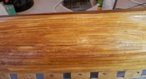

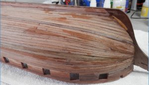

End of October and the plank bender has arrived. I chose a heated one in the end. I looked at vids of the plank crimper type in use and they seem to work very well in experienced hands - which mine are not. With the heated one I can bend, unbend, and a template with a couple of curves comes with it which will help me out. I did a few test pieces with it and soon got into the swing. The tool rest provided is only a cheap tin pressing (good enough for the job it has to do), but the weight of the cable drags it around, so I taped it to the worktop. Then after you have bent the wood you put the tool down on the rest, trial fit the plank, put the underside of your arm on the hot plank bender, stamp around, swear profusely and move it further away - learning point 2. First planking tomorrow; how hard can it be?

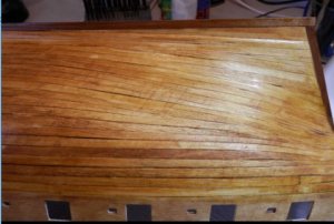

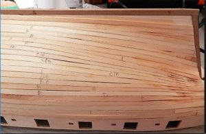

Hmmm. This is harder than I thought; and I thought I’d have it done in a day – it took three. I did not shape the first two planks beneath the gun-port bulwarks because I was keen to get the first one in place to glue the bottom edge of the bulwark along it’s entire length to provide some strength; on the second plank I just got carried away. I should have shaped them because I ended up with a step effect (see photo) and the planks were only glued to the bulkhead at the top edge, not the bottom edge. Learning point 3 – check all planks for shape and make sure the full width of the plank is glued down. I shall play the ‘First Time I’ve Done This’ card here – but you only get one shot and that’s it used up.
To soak the planks I appropriated the tallest vase in the house (don’t tell the wife) and that worked well. Learning point 4 – wet planks cut better because the knife blade does not follow the grain anywhere near as much. The advice to let a full plank run it’s natural course now and again and fit stealers where necessary was good – I didn’t fully understand how that worked until I did it. Also, save the wedge shaped bits you cut off because some of them make great ready-cut stealers. I really enjoyed putting in the stealers, so learning point 5 – I need to get out more.
I also planked the dead area of the keel and stopped just short of the stern post because, when I have sanded this down to almost nothing, the second layer of planking will take the overall thickness at the stern post to that of the rudder. I might be wrong in this, the plan does not show it, the instructions do not mention it, but others seem to do it on hulls of this shape and I think the overall shape and profile is better. Below are a couple of photos of the unsanded hull, warts & all.

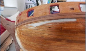

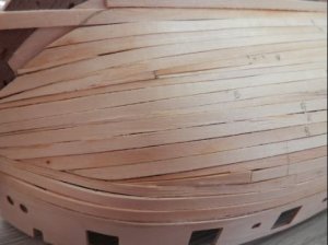

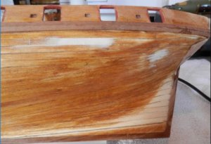

The aforementioned steps in the planking were fixed with a bit of filler. I used a small precision sander to smooth the hull and noticed that some of the planks were springing i.e. the edges not glued together. I could have gone over them with glue but in the end I applied a coat of sealer and this did the trick. I used some Knotting Shellac I had in the garage – this is the stuff you put on knot holes to stop the resin staining the paint overcoat. I used it for no reason other than I had it, but must say that I like the colour finish it gives. The superglue remnants could be sanded out to give a more even colour coverage on a final planking, but I like that sort of patchy look as it looks a bit weathered. Possibly a thought for a future model – but it stayed tacky for a couple of days. I am planked out and will take a break and make some deck fittings.

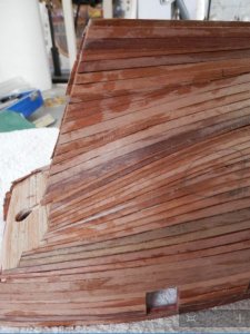

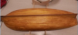

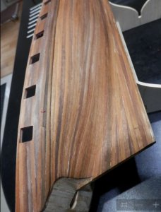

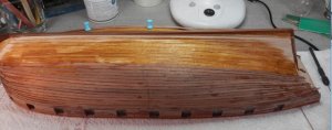

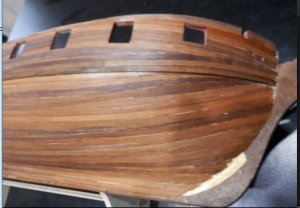

Final planking. Taking on board all I think I have learned, I started by planking from the gunport bulkhead bottom edge first. I did this in order to get a true and straight edge to work with. This also finally took me three days but I think the only way is slow and steady. The last two photos are of the hull unsanded, warts & all. Next post will show the sanded hull.

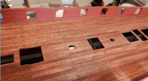

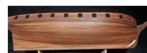

Second planking sanded and main wale fitted. I wet the hull with a damp rag to give some clearer definition.
