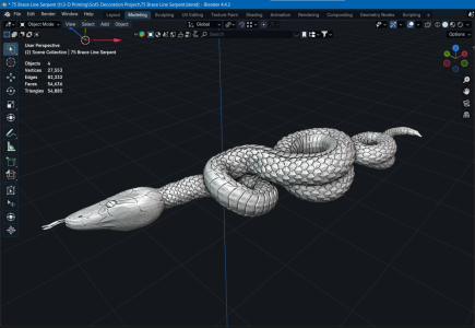

In total admiration with what you are doing and achieving with Blender. One question; do you isolate the images from an uploaded into Blender, photo or pdf, then reconstruct or do you create the profiles yourself in Blender by using/viewing external drawings?Starting on the CR (Carlos Rex) badge on the beakhead. The "C R" characters are shaped from appear to be roots or tree branches. In order to model these, I am using nurb circles. Basically, a nurb circle is a circle that has a a square made of four segments that act as handles, allowing you to resize or stretch the circle into and oval. So, if you take one circle, and extrude it many times, you can create a series of cylinders which you can shrink or stretch to form the branch shape whoch forms the "C". The crown is the same one used in previous work, but the eagle was modified and re-sculpted from an online model asset.
Close to being finish with the "C". The individual branches in the "C" are made as separate objects that are merged together using the Boolean Union tool.
Once this shaping is done, the object is converted from a series of nurbs into a mesh of polygons. Then the entire "C" shape is flattened a bit and attached to the background object later.
A little smoothing using the sculpt tools, and it's done. This is all done using the most basic tools and functions in Blender, and what take so much time is finding those functions among the hundreds of features in this program.

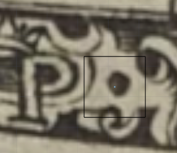

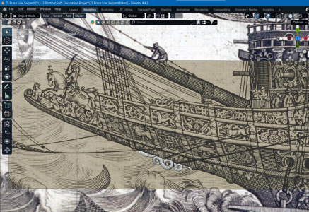

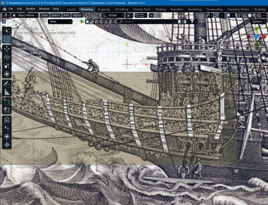

In order to create the models as close to Payne's engraving as possible, a high resolution .JPG image of the engraving is placed onto a rectangular plane. While I am modeling, the image is set to only appear when the view window is angled straight along the Z axis, looking squarely at the engraving image. If I rotate the view at any other angle, the background image of the engraving becomes invisible. This setting is to ensure that when I move points around, and the background image is visible, those points only move in the X-Y plane (right-left, up-down) and never in the Z plane (inward-outward), as if you were drawing on paper, and the back face of the object remains flat.

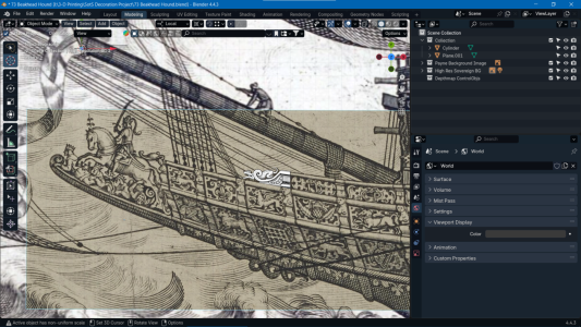

I have now set the background image to be visible and ANY angle, so now you can see the image with the view looking at the 3-D column objects from the side.
Now since this high resolution image STILL does not have enough detail, I use portions of a SUPER HIGH resolution image placed on a smaller rectangle located a very small distance in front of the first image.

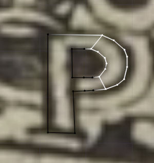

All my 3-D objects thus far are not created using software to convert a 2-D image into a 3-D object. Instead, I draw the outline of an object using points and edges just above the planes which are painted with the images of Payne's engraving.

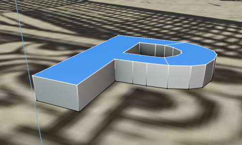

I start by adding a square plane.
Erase the polygon face, but leave the points and edges.

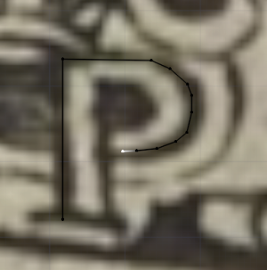

Erase some edges to leave a few points, and drag points to positions over the image we want to model. Let's make a "P". Here's a start:
Grab a point, and extrude (e) the point many times to trace the outline of the P.
After you are done traceing the outlines, create polygons from the edges and points.
View attachment 525593 View attachment 525594
Select the polygons and extrude them up along the Z axis.

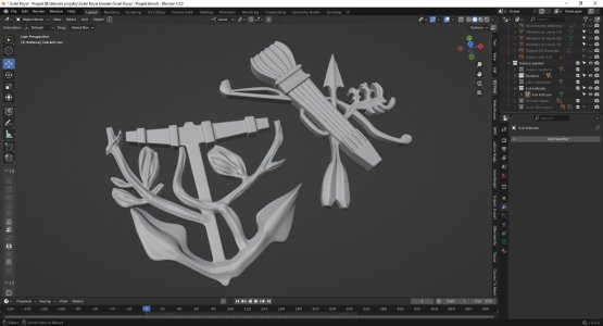

That's the basic idea on how to make the background portions of the decorations. The shapes of animals and other things in the foreground of each decoration are often created from modified 3-D objects others have made in order to save time, and because I'm not talented enough to create human figures and animals from scratch. I just bash others' work into shapes I need. It's how I can turn the upper object into the bottom object shown below.
All the functions I have used thus far are basic, and you just have to combine them in clever ways to get great results. The hardest part has been learning where the submenus and key presses are to find the right tools, then use them long enough to remember them. Once you have several methods of shaping the polygons, the complexity of your 3-D models increases.

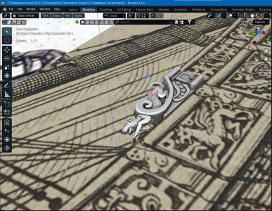

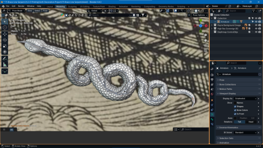

An example of 3-D model bashing; changing the pose of the hound from the 3-D asset found online to match the pose of the hound at the beakhead. First the section of ground was cut off the model and the hole in the foot patched. Then, and skeleton of bones was created inside the volume of the hound. The bones are set to be visible through the hound model at all angles to allow for easy positioning of them.
Once the skeleton is finshed and in place, it is linked to the hound model. Moving the bones will pull all the hound model polygons to new positions, effectively changing the shape of the hound model. Each bone has a magnetic field to pull and push the polygons around it.
Once the changes to the pose of the hound is done, the hound model is frozen in place and the skeleton is removed.
Any folds or pinced areas can be smoothed out with the scupting tools. Parts of the hound's stomach can be sculpted to better appear like the hound in Payne's engraving. Then the hound can be merged with the scroll once that is made.

To set up flat views you choose from 1,3,4,6,7,9.This setting is to ensure that when I move points around, and the background image is visible, those points only move in the X-Y plane (right-left, up-down) and never in the Z plane (inward-outward), as if you were drawing on paper, and the back face of the object remains flat.
OMG! I'm loving you people. This is awesome addition to Kurt's answer to my query. Cheers.Hello Kurt. You've made so much progress. At this rate, all the decors will soon be completed.
If you don't mind I would like to add some points to your advice.

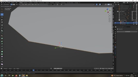

When adding a background picture you can also do some other small calibrations to make work easier. In top right corner you have filters, selecting filter is very helpful when working with background images as it lets you turn off your image from working files. When working with multiple images opacity slider is also a good option to play with. It lets you choose clearness.
For tracing I would use little diffrent technice as extruding vertex(points) introduces problems in sculpting phase of modeling. When adding more resolution to model it becomes impossible to sculpt.
I'll show you alternative method that leaves option for sculpting more details.
Same flower traced by vertex only and both vertex and edeges
VertexView attachment 525633
Vertex and edges

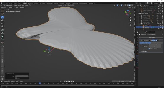

To sculpt a model we need to extrude in Z axis and add Plane cuts(CTRL+R). Plane cuts automatically divide model just roll up or down middle mouse button depending how dense mesh you want to be. With model traced by vertex blender limits plane cuts only to one edge while in model traced by edges, plane cut divides along whole model.
To prapre mesh for sculpting we need to extrude in Z axis and add subdivision surface modyfier, but before adding modyfier extruded plane must be also plane cut because without that it will become a messy pulp.
Now a little better
Still as I mentioned in beggining it introduces errors which doesn't allow sculpting. Mesh just becomes unstable for further sculpting
With other method the clay brush works properly. This is just only introduction. Sculpting itself is quite tricky to get it right. With more complex model you nedd even difrent approach to prepering mesh, but for simpler stuff it'll get the job done
Those are results after hours of work
