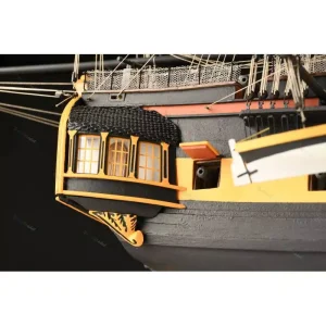

If you compare the side gallery roofs with a free download from the NMM draft, AL haven't got the shape correct, it's too 'domed'. Also the scalloped roof covering is too heavy. I would have to bash these, they are too obvious to the eye. Without the roof covering the shape might look a bit nearer to how it should be? I'd like to hear your conclusion on this when it comes to that part of the build.
Chris Watton got it right (of course) The Chinese kits have done pretty well. Why can't AL get it accurate? At over a thousand pounds I'd expect perfection.
It's hard to pinpoint what the production was really based on. Personally, i would have made gallery more massive. Fortunately, there's a way to compare it, both to Allan plan and to the film prop. Vanguard models aft gallery is much better adapted.
Thx Bob, I'll keep this one in mind when i get to that part.

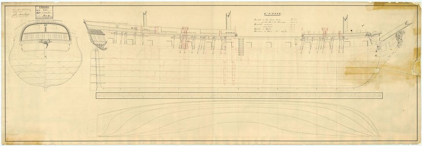

You are welcome, it is my pleasure to help. There are also drawings signed by John Marshall of her deck plans that you may find helpful in comparing with AL's version (which hopefully are the same) RMG is a great source of both design and as-built plans for thousands of ships, including captures like the French ship Unité which was renamed Surprise. If there is any doubt that this was a French capture. not an English built ship, the shape of the body plan above is a dead giveaway. :)
I once bought the plans for the shtandart, the tsar's yacht from the RMG, they are superb. Checked out the site found the quarter and forecastle plan and the lines and profiles but i did not find the one above for the original l'unité - I also keep the belle poule from ancre near as that one is also an original french vessel that ended up in english service.
