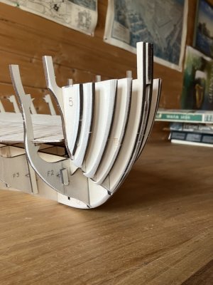

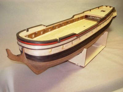

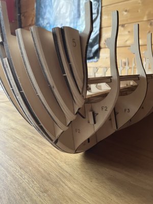

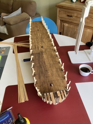

Started sanding the bow part, seems quite round by now.

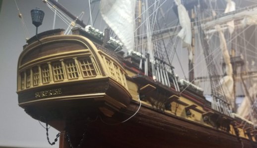

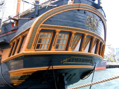

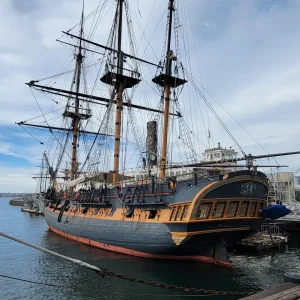

If you compare the side gallery roofs with a free download from the NMM draft, AL haven't got the shape correct, it's too 'domed'. Also the scalloped roof covering is too heavy. I would have to bash these, they are too obvious to the eye. Without the roof covering the shape might look a bit nearer to how it should be? I'd like to hear your conclusion on this when it comes to that part of the build.
Chris Watton got it right (of course) The Chinese kits have done pretty well. Why can't AL get it accurate? At over a thousand pounds I'd expect perfection.
It's hard to pinpoint what the production was really based on. Personally, i would have made gallery more massive. Fortunately, there's a way to compare it, both to Allan plan and to the film prop. Vanguard models aft gallery is much better adapted.
Thx Bob, I'll keep this one in mind when i get to that part.

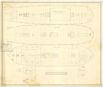

You are welcome, it is my pleasure to help. There are also drawings signed by John Marshall of her deck plans that you may find helpful in comparing with AL's version (which hopefully are the same) RMG is a great source of both design and as-built plans for thousands of ships, including captures like the French ship Unité which was renamed Surprise. If there is any doubt that this was a French capture. not an English built ship, the shape of the body plan above is a dead giveaway. :)

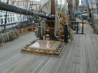

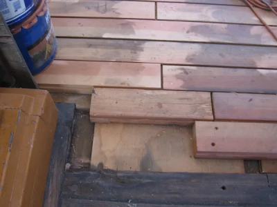

Did the French deck pattern usually have a two butt shift pattern like in your model instead of the stronger and more common three or four butt shift like the British? In looking at photos and video, I was really "surprised" the Rose (AKA Surprise replica) decking has no discernable butt shift pattern at all so is of no help.
Thanks
Video:
Photos:

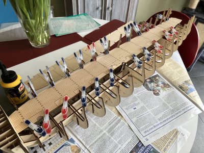

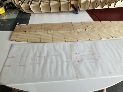

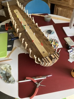

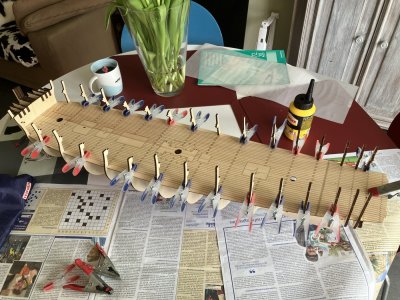

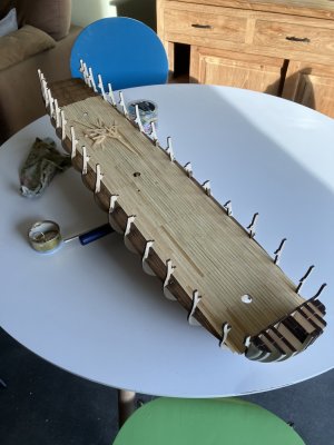

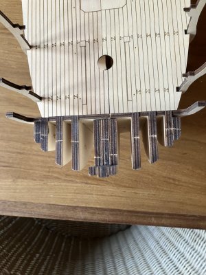

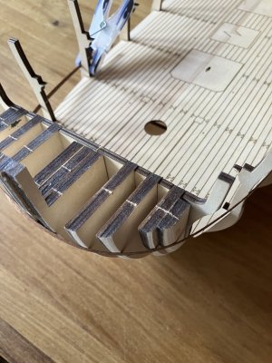

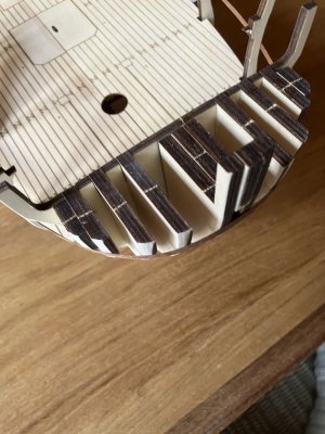

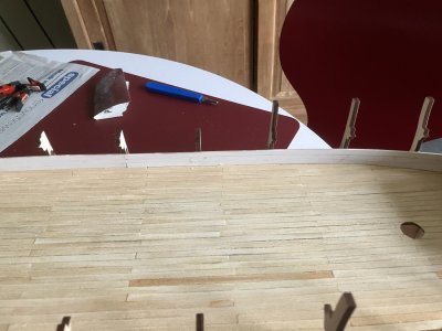

Decided to replank as i was not super happy with the way the deck turned out and bit worried that i will need a different deck arrangement as i want to build the orignal french frigate, and everything was preprinted on the deck. A bit blocked now as i miss 2 or 3 1 x 5 mm planks to finish the deck planking. Not sure yet what i will uses for the deck planning nails, any ideas are welcome.
Will drive over to the model shop next weekend to fetch the missing planks and some additional wood planks, in order to be able to finish the deck.IMG_0329.JPGIMG_0330.JPGIMG_0331.JPGIMG_0332.JPG
