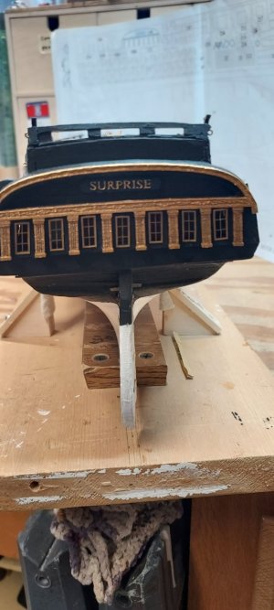

Question for the group...the directions for the rudder seem to show a little block of wood for the pins, but I cannot find any references to that other than one picture in the directions. Any ideas,or how you handled it?

I'd watch "Master and Commander", there's a few scenes where the after of the ship is shown.
What do the picture/s look like.
Here are the pictures from the instructions and the parts to use.
I did build a small boat with an attachable rudder which I had to build the pintles for, so I am "assuming" this will be similar. The boat will be replacing the metal one that came with the kit.
Unfortunately the plan drawings are for an old version of the kit and do not show the new PE pieces.
I think if you look at the image from YouTube you might get an idea how to proceed.
FWIW and for the future, deck planking was not done like the kit shows. The pattern was either 3 or 4 butt, not two. An exception is the orlop where there were often short planks set into rabbets in the deck beams or rested on the top of the beams with battens on top of the beams.
Have you compared the contemporary drawings of the Surprise with the Mamoli version? I only ask because the rudder does not look like a rudder on any British ship in the 18th century
Cheers,
Enterprise 1774
Hind (28 gun ) 1785 showing the shape of the rudder and the size and number of pintles and gudgeons

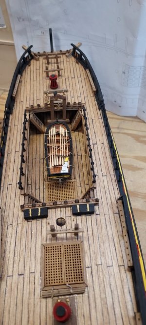

A bit of an update...main deck furnishings completed, need to install and rig the guns and carronades (I am just using the kit-supplied guns, etc.).
Getting ready to start on the bow.
