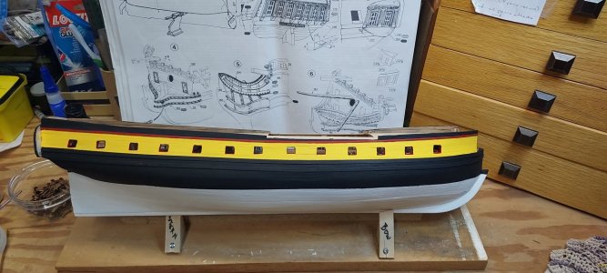

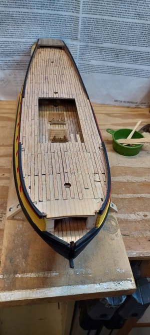

Well, here is an update on the Surprise. I have finished the hull painting (the yellow strpe is actually more of a golden yellow than the picture shows), the bows are in the proper shape (I think) and the decking is now complete.
I have the side handrails built and installed and the bow pin rail is done.
