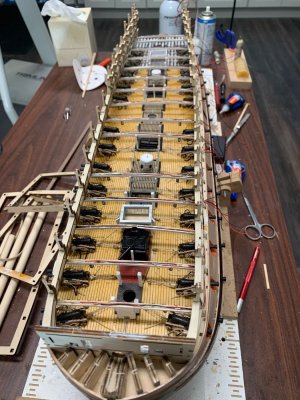

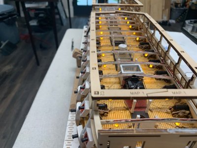

You will see from my build log I'm somewhat behind you just finishing the first set of lights in the hold. I had zero soldering experience before this build so did struggle and walked away from the build for a while.
Hope you enjoy your holiday in Europe!
Now back to those lights.
Tony

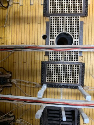

I actually figured out about that 1/2 way through that if you press the wires I got the channel of the beam and use a small clamp to keep them
in position it’s easier to just solder them in place and they come out flatter in the channel.

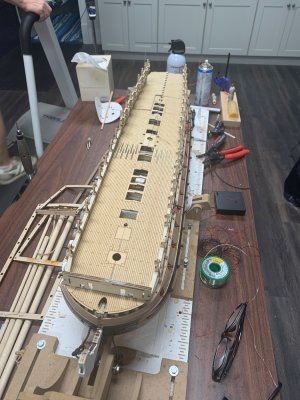

Back in the saddle. I recently got home from out trip to Spain and managed to do a little work on the ship while managing catching up in the garden and finishing my case for the HMS Victory Shipyard kit
When I left I was in the middle of the middle deck beams and lights. I manage to finalize these and will be working on the inner and put hull pieces to hide the wiring before I put the upper deck flooring in. The upper deck flooring is just loose for now as I have to make sure it fits correctly. Once I catch up on the yard work and gardening mess which I ignored for 5 weeks I’ll get back to moving along. Cheers

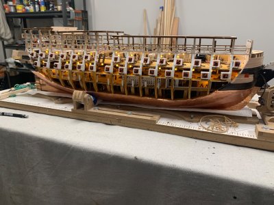

Fantastic progress. Great achievement when you add another deck.

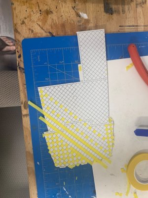

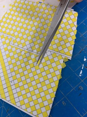

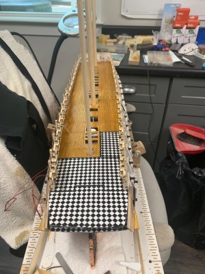

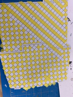

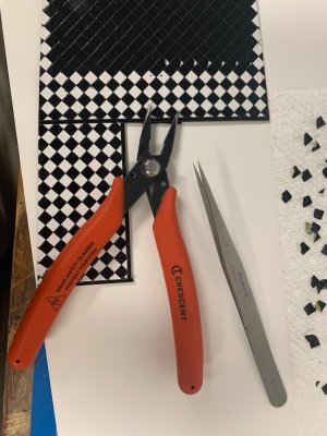

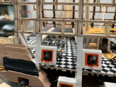

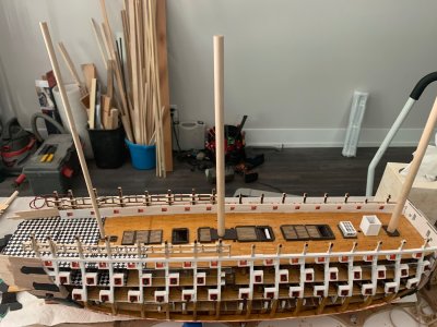

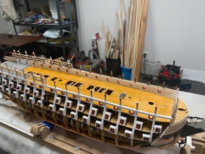

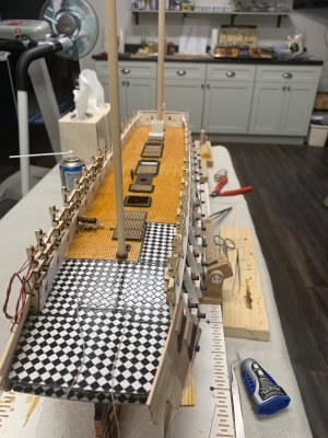

I got the upper deck flooring in place. For the admirals quarter floor I found a few tricks. I tape every other row with 5mm tape on the diagonal. I then use an exacto to cut between the rows and then lift the squares onto the row below and so on. When removing the tape I found it best to gently peel a corner of the tape and then use crescent pliers to pull off the tape. Came out better than the middle as I had to do a lot of touch up.

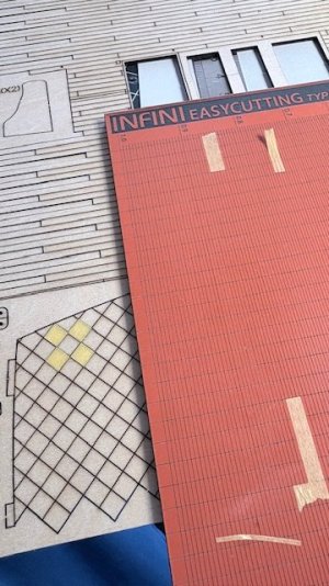

Great minds think alike. I am tossing up whether to use a single sheet of masking film and cut out all the diagonals and remove every other square. Or use my Infini cutting mat which has grooves every 5mm and adopt a similar technique to the one you are using. I don't have 5mm tape on hand (but can source online) but, I do have lots of 10mm Tamiya tape which will be a breeze to cut in half using the cutting mat.
When the time comes I will see which way to go.
Just as a matter in interest did you airbrush the white on the deck or hand paint?
T
Yep. I was at the hobby store months ago and saw some yellow tape. Turns out it was 10mm so if you need more I can send it to you. Turns out I think 10mm is pretty close to 5mm when I don’t actually measure.
Finally got the 5mm on line.
Thanks for the offer, but I have heaps of 10mm which I will cut in half. Happy Days! Modelling today it's heavy rain here in Brisbane!

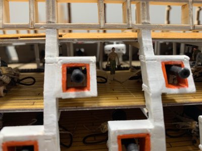

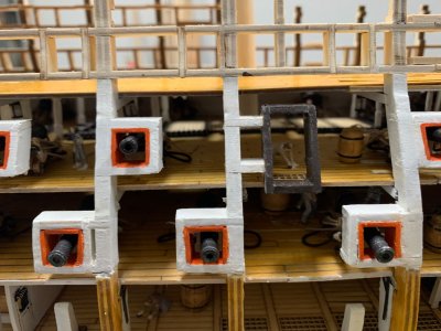

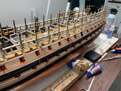

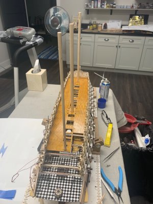

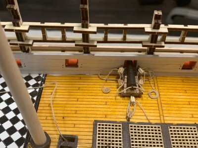

There’s been quite some rain the last couple weeks so I have been doing work on the rainy days. I duplicated lower decks with the appropriate ladders, pump etc. Thought I would try my hand at cannon rope coils. Used a 4mm dowel and two sided tape. First one wasn’t great but I think the rest will look good. I’m only doing the 12lb upper deck and cannons on quarter/poop as needed since these decks are more open to view.
