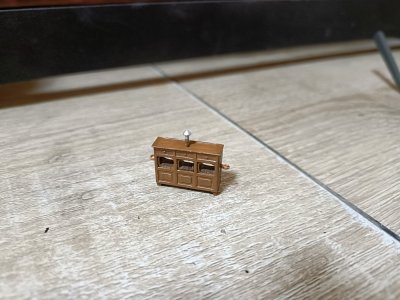

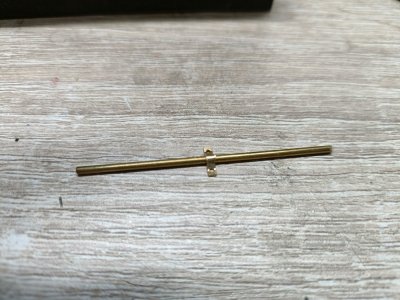

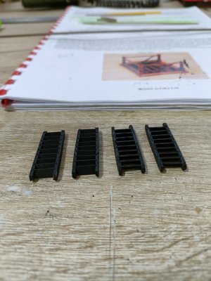

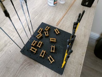

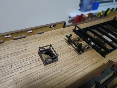

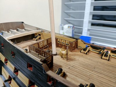

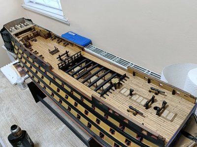

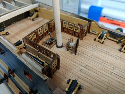

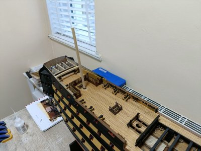

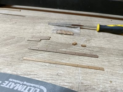

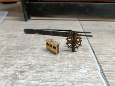

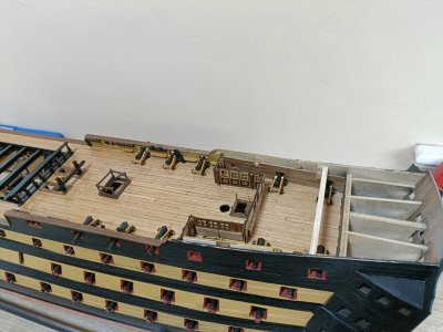

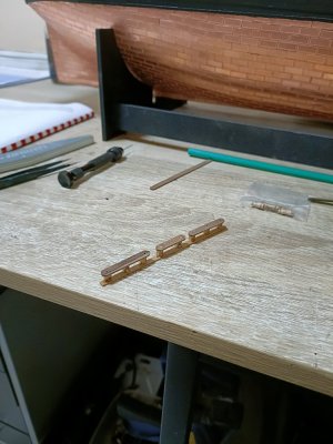

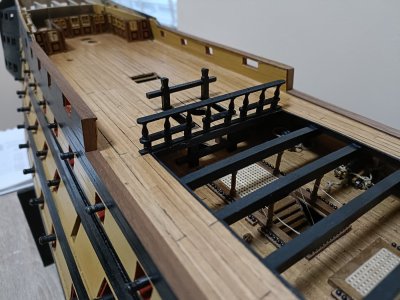

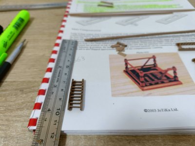

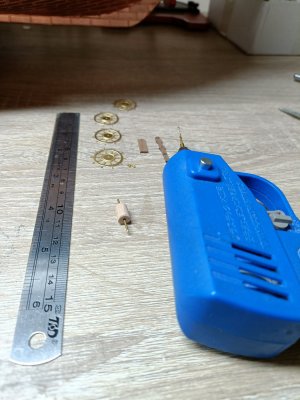

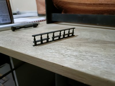

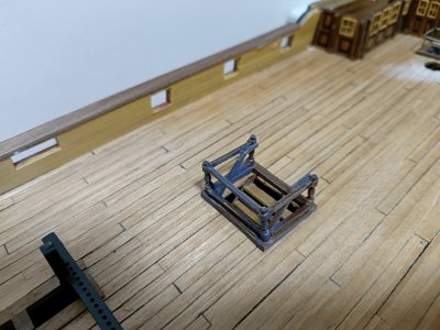

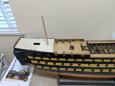

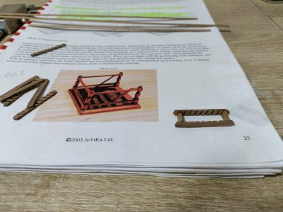

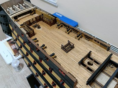

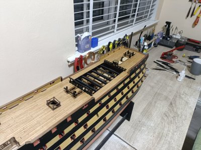

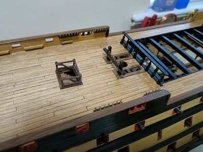

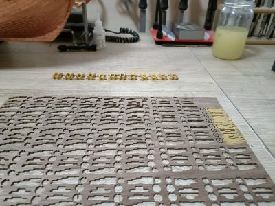

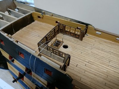

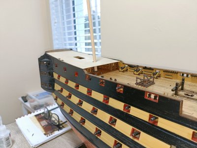

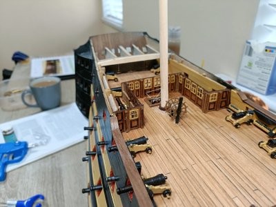

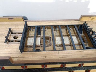

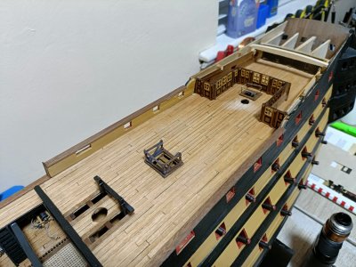

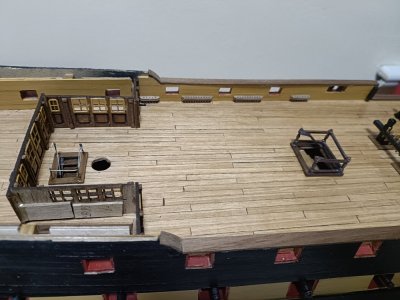

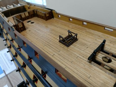

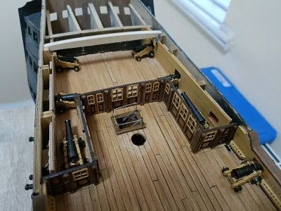

Three hours done not a lot to show for it
IMG20260115171122.jpgIMG20260115171127.jpgIMG20260115171133.jpgIMG20260115171138.jpgIMG20260115171142.jpg

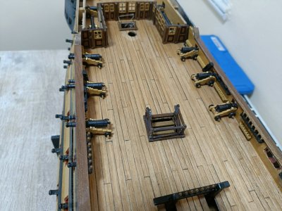

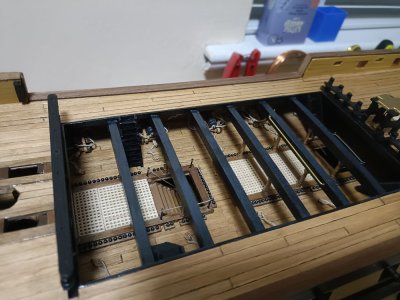

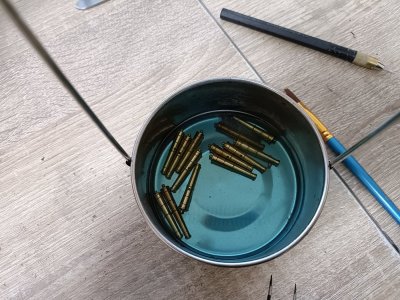

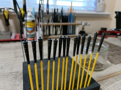

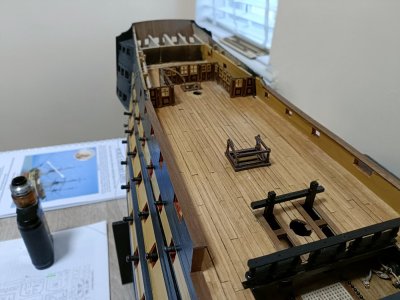

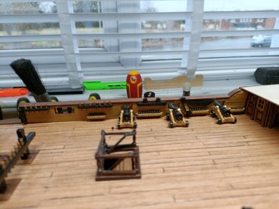

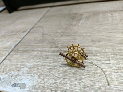

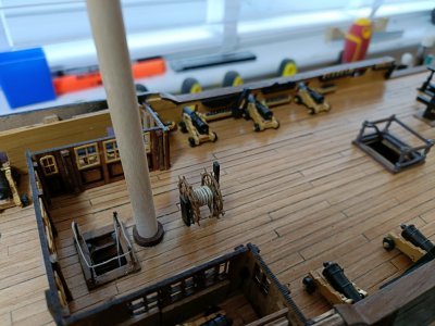

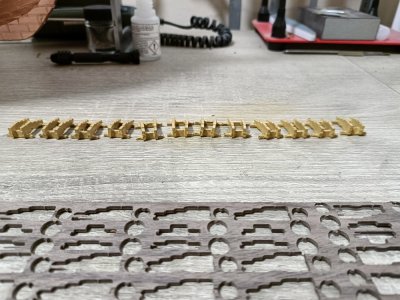

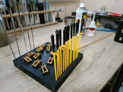

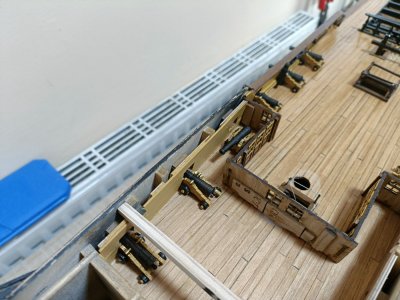

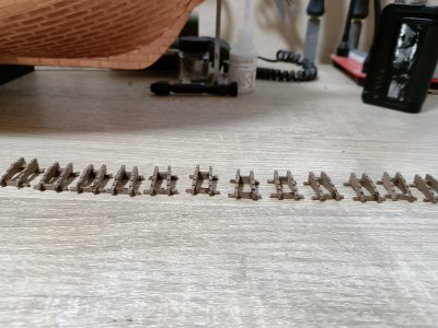

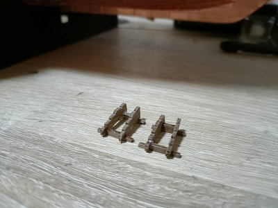

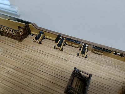

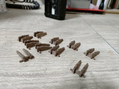

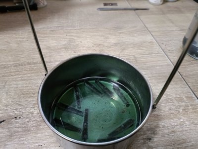

Afternoon, after fitting the inner bulkhead stuff and turning the page ......More guns 12 lbs 12 long barrel short and 2 long barrel medium, had some blueing fluid left, so did them I think they look so much better than paint I will build the carriages up tomorrow

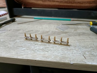

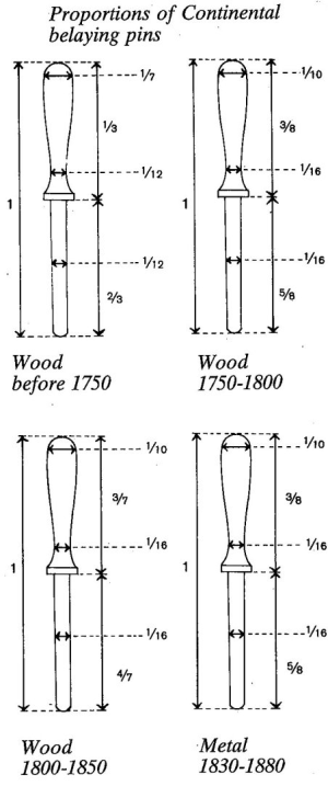

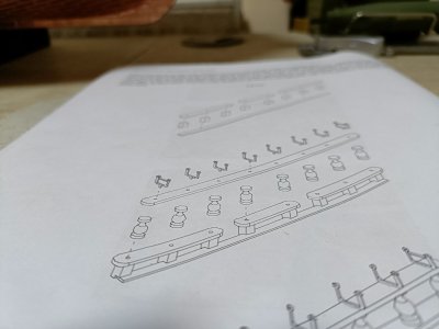

Thanks for the reply. Hopefully the following will be of interest and useful.
From Mondfeld Historic Ship Models:
Generally speaking, the lower diameter of a belaying pin was never less than the diameter of the rope which was to be belayed. As only one size of belaying pin was kept on board, its diameter was that of the thickest rope to be belayed."
Starting with the largest rope diameter to be belayed, and using that as the lower diameter of the pin, you can calculate the overall pin length from these diagrams.
For example, if the largest rope was 1 inch diameter and the pin was wooden from after 1800, the pin length would be 1 x 16 = 16 inches.
