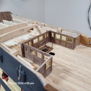

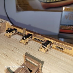

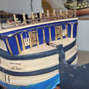

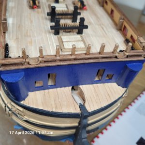

Bit of quarterdeck work...i was getting tired of some nitpicking really trivial criticism then discovered I could ignore the member and not see their posts...LOL Great facility. I welcome suggestiions on how to do things better but every build is, in the end, an individual kit bash not a graduate paper in historical accuracy. That said I do try to get the history right if I can..eg..i have painted Admiral Paints 45% Yellow Ochre mixed with 55% Flat White, and the area commonly black wasn't really and I have used charcoal...( It is Vallejo Dark Grey) it looks good but to be honest I think I should have either gone a shade darker or mixed in a bit of dull black...but it is done. Mixing in a splash of Admiralty Dull Black would have been the right option.

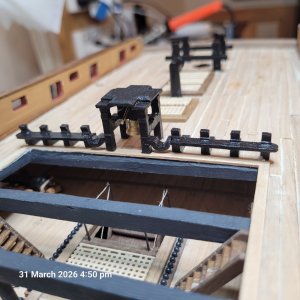

Incidentally it is not at all important but there is, I believe, an error in the plans which show poop deck support 38 positioned behind bulkhead (17 ?) or what ever..it clearly needs to be in front. Ans as you csan see I have followed the plans, the instructions, and the history with mitred corners.

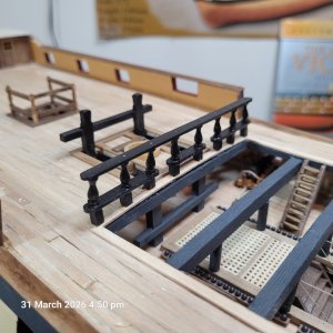

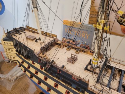

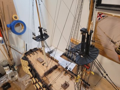

Well into the standing rigging now, very hard to take good photos of this stuff...but here are a couple. One thing I am a strong believer in is that many kits (including Victory) have you doing the main shrouds very early right at the start of the standing rigging. From my experience this is a terrible idea and I do them as late in the standing rigging as possible certainly after all the stays and preventers are installed. Why would you try and do all that stuff reaching around and through the shrouds.?
Thanks Bryian value your always encouraging comments.I am realistic about my need to kit bash a bit with age and dodgy fingers ..cant tie mouses so kit bash with brass rings... but a few of those things aside it has been a huge job, much more than I expected. At least an 18 mth project. I need to do something completely different next.. Amati "big" J4 Endeavour. 1: 35. When the partner discovers the size I will have some challenges...LOL
That’s a valuable point… Since, unlike on a real ship, we usually glue the masts in place, there’s really nothing stopping us from installing the shrouds later — in whatever way is most convenient for the modeler.

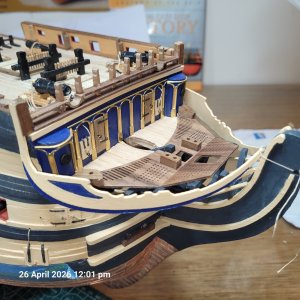

I am with Bryian here- lovely work
