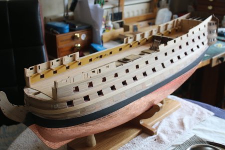

Hi Everyone, love this discussion as I too am build my Caldercraft Victory. From a few paintings I looked at it I too believe the gun port lids were also the yellow ochre (whatever shade that might be).
I will put paint the gunports yellow ochre and have them closed. I like the closed look, maybe just on the port side. Question, would the gunport lids hardware be black or would they too be painted yellow ochre.
Any thoughts?
Thanks Grant
Any thoughts?
Thanks Grant

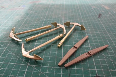

Grant, here's my Vic with the lower ports closed, & scratch built brass anchors - the kit 'monkey-metal' ones are like liquorice; they're not straight & bend if you s much as look at 'em. I would say the hardware on the port lids were black.
Stuart
Stuart
Hey Stuart,
what great anchors. How did you make them? I would be very interested to know. How big are they and how thick? Have you done a build report on them? The Vic looks really nice ...

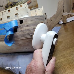

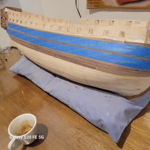

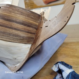

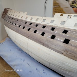

Thought i would mention early in the build that the quality of the Caldercraft kit cf. OcCre Montanes is an order of magnitude better. Full sized plans, three layers of hull material..Lime, Mahogany and Copper. Just finished the first layer and it can actually be bent around the bluff bow without heat and doesnt break...i did use heat to make fixing it easier but this is the best wood I have ever had in a kit.

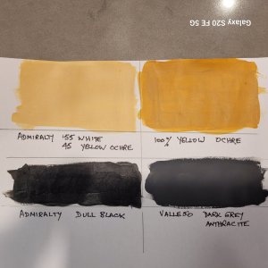

I have done some paint trial mixing and settled on a blend of two Admiralty paints Yellow Ochre (approx 55%) and Matt White (45%)...maybe 50/50 but then i put a little more white in ...I guess it is just pale yellow..? At least it isnt pink. The "black" which wasnt actually black I have found Vallejo Dark Grey (#175) which is a good charcoal colour, and the masts are Vallejo Cream White (#021)...so I am happy to move on from the colour issue with my choices made.
well i dont think laptop dispolays are all that accurate but here is where I ended up with ther critical colours for my Victory...I think the bottom notes are self explanatory
Seeing it posted I can only say it looks better in the flesh, particularly the grey which looks really good. I made the yellow to approximate the amounts carried in the ships carpenters store..? you can see that the admiralty straight yellow ochre is much more like the colour up to 2020 or whenever they painted it pink ( just kidding...LOL)

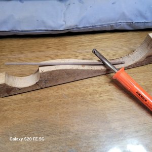

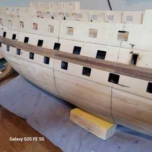

just done three runs of walnut planking ...i discovered on my last boat that laying top planking in scale/small sections is a lot easier to do and a better result than wrestling a full length piece. In this case the stagger doesnt matter as virtually all the planking is covered with Wales or Copper.

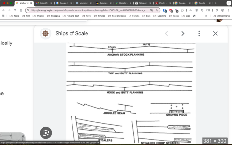

I am planning to do anchor stock planking for the main wale as it was on the real ship ...not sure If I can pull it off but can only give it a shot as below

Hi,
How do you determine the correct breadth of the planks at various stations along the hull? The taper looks good, but how do you know how much to do?
Thanks
I finally got curious and looked up Mallacoota. BEAUTIFUL area!!!!

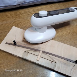

There are lots of planking tutorials online in this forum which explain the correct way to do it with diagrams. But these planks will be covered with copper so I just tapered the last 150mm (enough to get around the bluff bow) down to a little more than 50% at the stem end. Then i bend them under an iron while damp so they have a flat curve, then a curve around the bow with a soldering iron. These two curves enables them to sit flat against the hull with virtually no edge set. If there is any part standing off I wet it then iron it flat with some CA under the section. With this approach the level of the stem ends progresses well down the stem staying about level. Hope that helps. The little travel iron was a great discovery on EBay for $11. if you have a plank bulge get some CA under the bulge after wetting it then put on the iron which simultaneously flattens the bulge and sticks the CA.....which of course works fastest on wet wood.
