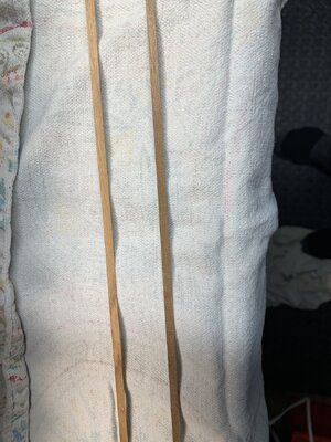

I have a few questions for you. Did you have enough lathe to do the decks? Y.T. said that he did not have enough. The instructions say that the decking is Tanganyika lathe. I am not sure what that is. I found that there are loose lathes that are dark and there is a bundle of lathes that are light. Both are the right size but I don’t think that there is enough of the loose lathes to do the deck. What did you do?
Hello there Jim. In your picture the deck is made with a whitish wood. The wood I thought I was supposed to use is dark but the kit has lots of a more whitish wood that is the same size. I have lots of the strip on the left but not enough of the strip on the right:
IMG_9392.jpegI hope you don’t mind a lot of questions … If I can use the light wood, I can continue, but if it’s for something else and the dark wood is for the deck I will have to try to find more. Unfortunately I can’t find a parts list that will clarify.
Have you measured the wood? The deck planking is 0.5mm x 4mm. Tanganyika is light coloured.
The wood on the right looks like one of the walnut laths for second planking, which from memory is 0.5mm x 3mm.
Thank you again for your timely and extremely useful response. I can now continue since I have lots of the .5 mm by 4 mm light wood and will continue using it for the deck.

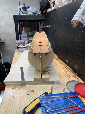

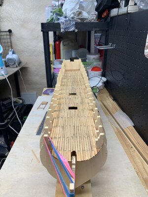

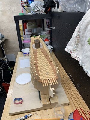

I have moved on to the decking. It is not a perfect job - I found myself veering from the centre line half way along. I followed the instructions to use a pencil to highlight the joins but did not take into account how dirty this would be. I will see what I can do to clean up once I have finished. I also painted the ‘below deck’ black. Would not have thought of that without the picture posted by Jim D.
I thought I would have enough of the strips to do all the decks but it looks like I too won’t have enough for them all. Will cross that bridge when I get to that point.
I have learned a lot from putting on the decking. It could look better but it could look a lot worse. I am counting on the various articles on the deck distracting the eyes from the flaws … I am pretty sure that future decking will be better.
I realize that paint can cover a lot of mistakes but in this case I am going to leave the decking plain, if grubby.

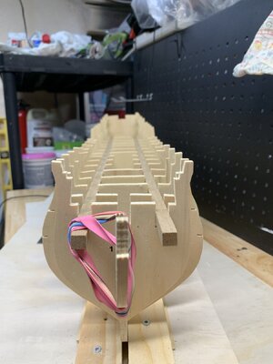

You can also see that the prow is still giving me trouble. It will sit straight for a while, then revert to its old habits….
