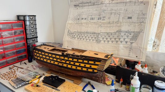

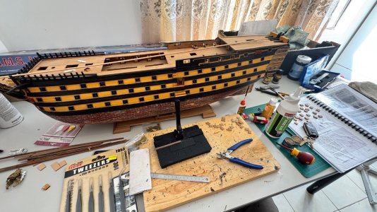

Model Shipbuilding Progress – HMS Victory (Mantua 1:78 Scale) ⚓
I’ve recently begun work on this stunning Mantua HMS Victory model—a build that was generously gifted to me. It’s a magnificent kit and I’m thoroughly enjoying bringing it to life!
Copper Plating
The hull came with quite a bit of tarnish on the copper plates, but instead of stripping it back, I chose to seal and preserve the patina. I love the aged look—it adds realism and gives the impression of a battle-worn ship that’s seen years of service at sea.

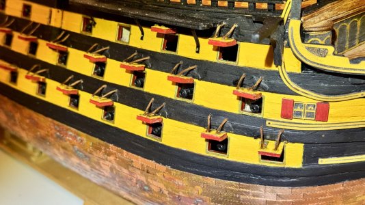

Cannon Ports and Ropes
I’ve finished mounting all the cannon doors, and they’re now fitted with opening ropes—each one hand-tied and secured in place. It adds so much character to the sides of the hull, especially with the red and yellow detailing that really makes the gun ports pop.
Deck Work Begins
Deck planking has been cleaned and oiled, and I’ve started detailing the internal cannon bays and deck structures. I’m focusing on adding realistic touches like brass hinges on the deck hatches and careful wood staining to bring out the grain and contrast between levels.
This is just the beginning—still lots of rigging, masts, and fittings ahead. But it’s really starting to take shape!
Plans in the background keep me honest.
️ Patience and details make the difference.

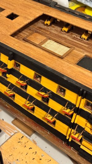

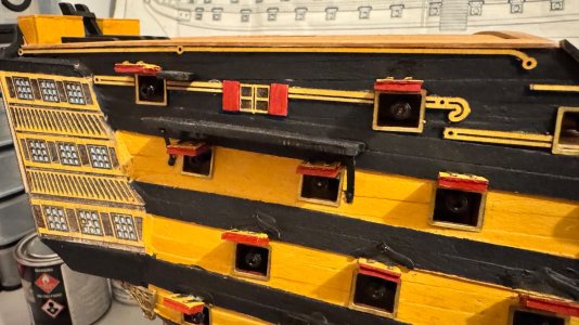

⚓ Model Ship Update – HMS Victory (Mantua 1:78 Scale Build) ⚓
Another milestone ticked off on my HMS Victory build! I’ve now detailed the lower section of the upper deck, bringing even more life and historical character to this majestic ship.
Newly added elements:
Cannon ropes have now been fitted, complete with realistic coiled lines and belaying details. These ropes add not only function but also a strong sense of authenticity, as if the gun crew just finished securing the deck.
  • I’ve carefully installed two open deck gratings, framed and placed over the deck hatches – allowing light and air to pass to the decks below, just as they did aboard the real Victory.
  • A set of deck hatches have also been added with subtle weathering to enhance realism.
  • Small stowage details and rope coils now dot the deck, echoing the bustle of a ship ready for action.
The surrounding gun ports with yellow cannon carriages are now tucked neatly under the upper deck, and I’m really pleased with how the contrasts between the timber decking, black-and-yellow hull, and coiled rigging are coming together.
Each detail adds another layer of realism and tells a bit more of the story of this legendary warship. Still a long way to go, but it’s immensely satisfying to see this deck come alive!
Stay tuned as I move upward through the ship’s decks and start preparing the next stage of the rigging and fittings.

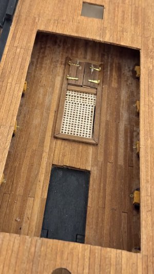

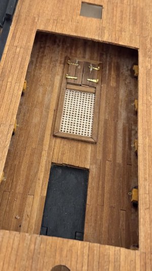

Lower Upper Deck Nearly Done on My HMS Victory Build! ⚓⛵
Progress continues on my Mantua HMS Victory model and I’m excited to share the latest stage— the lower upper deck is now nearly complete!
This section has really brought the interior to life with:
Detailed yellow deck supports
⚫️ Black-painted deck beams
⚓️ Cannon carriages mounted with rope coils and tie-downs
Beautifully planked deck with authentic wear and texture
Two staircases still to be added to finish off access between decks
I’ve also added finely detailed grates and hatch covers, giving a glimpse down into the inner workings of the ship. Once the stairs are installed, this deck will be topped off with four lifeboats which will rest neatly across those support beams—just like the original!
I’m really pleased with how this is shaping up. The combination of colour, texture, and layout is beginning to capture the feel of the real HMS Victory. Onward to the next step!
HMS Victory Build Update – Lower Upper Deck Complete! ⚓
Another milestone ticked off on my Mantua HMS Victory build! I’ve now added the final details to the lower upper exposed deck — with the ladders now fitted, this deck section is officially complete. Really happy with how the deck grates, ladders, and hatch frames have come together. The yellow pillars and support beams add a great structural feel and contrast beautifully with the dark deck beams.
You’ll also spot some of the coiled ropes and finer details being added, which bring more realism and life to the ship’s interior.

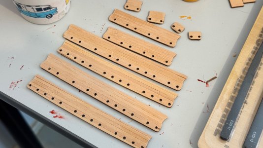

As for what’s next — I’ve begun building components for the next level up. In the last photo, you can see my workbench with the black-painted railing section I’ve started assembling. It’s slow and delicate work, but seeing it all come together is worth every minute.
Stay tuned — more to come as I work my way up the decks! ⛵

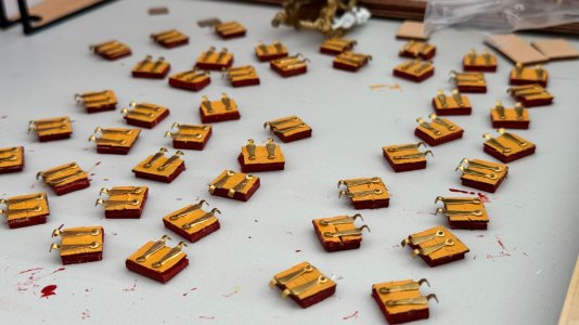

⚓ Mantua HMS Victory Build – Deck Safety & Cannon Prep ⚓
Today’s progress brings an important step in bringing the upper gun deck to life — the balustrades are now in place, adding that essential safety barrier for the crew. These were critical on the real HMS Victory, helping prevent accidents during battle or heavy seas.
I’ve also stored the ropes neatly coiled around the deck — these will be used to lash each cannon securely to the bulwarks during firing. On a ship like Victory, this wasn’t just for show — the recoil from each cannon was massive, and without these ropes, a runaway gun could tear through men and timbers alike.
When fully armed, HMS Victory carried an awe-inspiring 100 cannons, capable of unleashing devastating broadsides in the 17th and 18th centuries. It’s hard to imagine the noise, smoke, and power when this ship went into action!
Bit by bit, the build is evolving into a faithful tribute to this legendary vessel. Next up — more deck fittings and rigging details to bring even more realism.

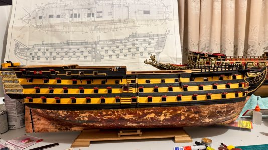

LOOKING GREAT
The qualit of the wood id great
When you start the rigging
Do he BowSprit and Lower Masts first
Rig Bowsprit to Fore then Main and finally Mizzen
You can get it all lined up
I would have suggested you fix the Gun POrt Lids after Rigging as they get in the way You might be able to cover them as the rigging snags in them
Dont forget the Ratelines on Victory are WHITE
ENJOY
