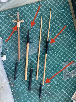

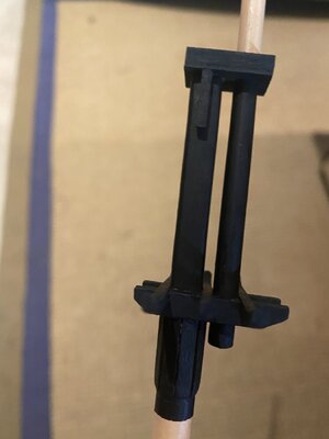

Worked on the upper masts and top gallant masts. I am not following the instructions other than to get the measurements correct so I hope “Grants creations” work. WIP so far:
The arrows indicate some of these : I squared off the upper dowels ; used some leftover deck 3x0.5mm planks to make the tresses tree supports on each mast, made the Hallyard and stay block (seen on mizzen) from 2x2 wood ; and used a toothpick for the connection of the top mast to the bottom portion. Hopefully when I put this all together it will make sense.

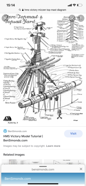

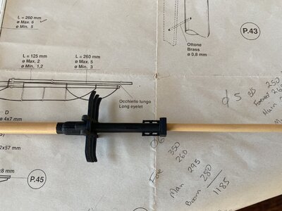

The top mast diagram being used : Boy I think I will be rigging for yearsRedface.

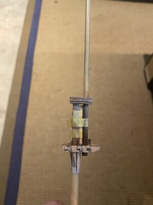

Good morning. Let me attempt to pull together the work on the upper and top gallant mast work I have been doing.
Base work- The problem area was mainly in the changes to the gap between the squared off portion of the top mast and the lower end of the Top gallant Base. I had to increase the width as I will be seizing the shrouds and they would not fit the kit dimensions. The cap and tressel trees needed adjustments. To get this I used a 2mm+0.5mm spacer and strapped it to the mast. Then glued the top gallant mast and cap. I inserted a small dowel after placement into the cap. Hope this is strong enough.
Sanded and painted :
The only disappointment for me is no matter what I tried I could not make the lower part of the top gallant a hexagon. Left it as per instructions and I am happy with the outcome.

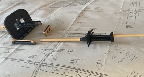

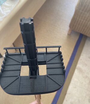

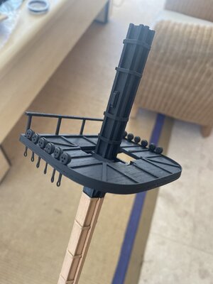

Now I need to fit this to the lower mast- here are the parts. The alignment of this is going to be an interesting challenge for another time. To make it all work I needed to break down each part into individual portions (as I have been showing in this log here and there- I do jump around a lot. )“Eish” a super confusing log this isROTF) .
I do need to do a lot of work fitting blocks, strops, deadeyes etc to these masts so I will only put this all together once this is completed. Stumbling along with no instructions I am....Yoda speak.ROTF
