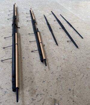

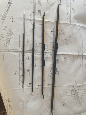

So do I, Grant!Good evening. A little progress and some experimentation. Some more yards and spars.

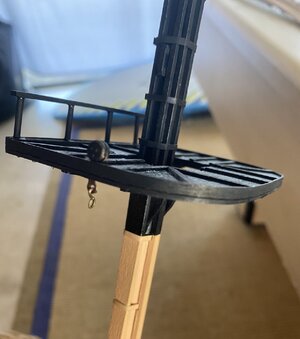

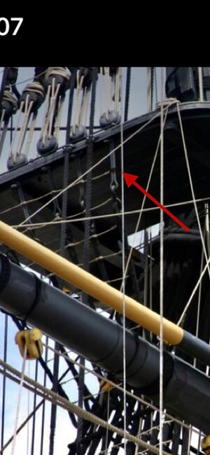

The dead eyes and strops for the futtock shrouds and top masts. I have been experimenting a little. Here is what the Portsmouth Victory looks like :

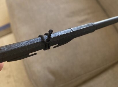

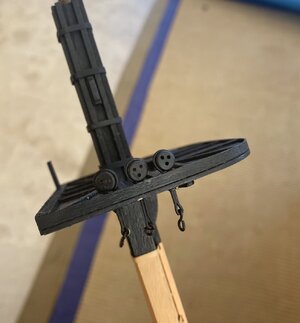

My initial construction of the Mizzen was to make as per instructions Where there are none and the shroud line goes directly up and around the deadeye-like so :
My “Siren” began to sing...experimented

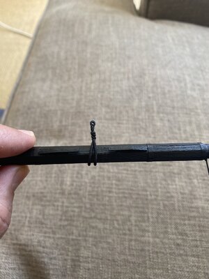

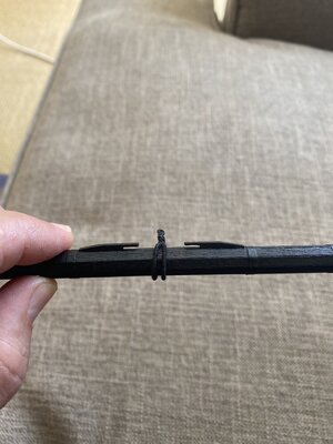

First attempt- looked nothing like picture above:
I then tried this :

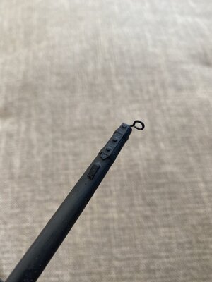

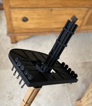

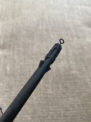

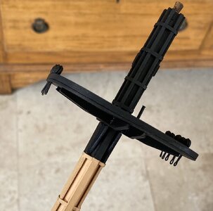

I made some Strops and some hooks for the futtock shrouds using 0.6mm wire. Shaped with needle nose pliers around a 0.5mm drill bit for the strops and a toothpick for the hooks. I think it adds better detail to my Victory. I bound the strop with 0.25mm thread where it passes through the top below the deadeye to secure it to the top.
Broke my railing when inserting these as they need a little manipulation- Eish. Will be easily fixed tho. I quite like them

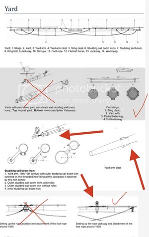

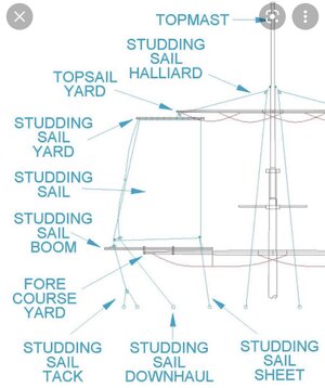

.Doing some reading I came across this (red marks are mine). Apologies if a little small.
. You're a quick study...I remember when you didn't know any nautical/ship terms. Now I can't even track with what you are saying. You're a quick study...
“Monkey see- monkey do” “copy and paste”-I would say I do not even remember a third of what I have read so far. You probably can’t track,Paul,because my paraphrase posts don’t explain very well...

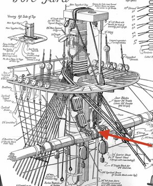

You're doing a top job Grant, but every time you show that diagram of your topmast I get a bit dizzyOk no wonder I could not tie it off nicely: got it totally wrong!!!
A picture seen before- I refer the red arrow. Guess I am going to have to redo.
