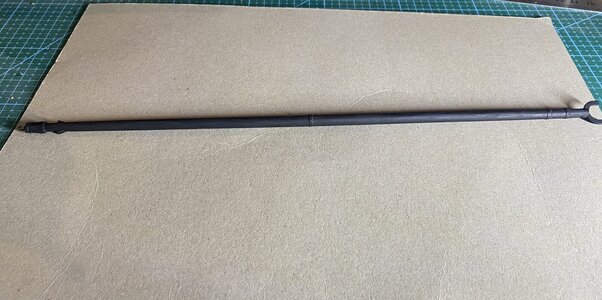

Here is my process to my building the masts, yards, booms, spars etc. Perhaps my log has been a tad cavalier and confusing so I thought it is time to attempt a more logical presentation.
The driver boom for the Mizzen-
There are so many references for the Victory and from the time when building started in 1759 to present so many “upgrades”and changes have been made. This at times makes references difficult as to which period does one choose. No doubt the best modeling practice would be to buy a reference (e.g. The Anatomy of the Victory) and stick to this plan.
When I started this model I followed the Mantua plans and quickly realized it was not any where near the detail of the ship at any era in its lifetime. My ship is a hasmash of many eras and I really have had fun making multiple changes- apologies to the purists out there who make outstanding models. This hobby is a time out for me from a hectic and stressful business environment so I keep it fun. That is me- it is an escape.
All my masts, yards etc are simulated from McGowens diagrams and this is an early period design. I simulate what I can with limited resources.
My process I have used:

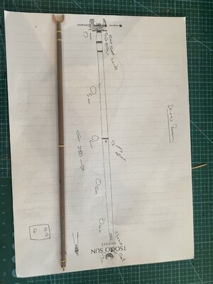

I draw a rough diagram to get the scale correct- this is most important. For the boom the most unusual aspect for me was that it was tapered at each end with the thickest 6mm in the center going to 3mm at the end and 4mm at the mast end. I used the kit supplied mast “connector “(don’t know nautical term). Used 1.5mm (Cut to size) Tamiya tape for the bands and simulated the brass supports from 0.5mm deck planks cut to size.
The later Victory has a sheave near the end of the mast, however the earlier diagram uses cleats. To be Sanded and painted.
