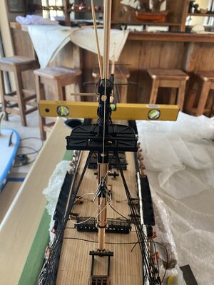

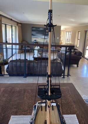

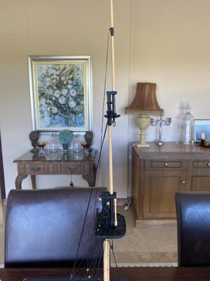

Good afternoon. I realized I did not post the fitting of the Mizzen topmast and top gallant. I did this prior to my Moms visit. It is Something I regret doing as it would have been easier to fit all the many blocks and rigging off the ship. Rookie exuberance and enthusiasm.
It was a challenge as I did cut the topMast at the cap (as shown previously) in order make the octagon where it fits into the tressel trees and modifying the kit build to achieve this.
I used a sprit level, plum line (homemade) to get it into line. All came out better than expected other than the 3 degree rear offset. Mine is 2.4 degrees- Not going to really notice it- my uncalibrated eyes (to use @Vfordyce term) tell me;).
Great pictures Grant, it's all coming together very well indeed. Totally commiserate with you on the sequence of things when it comes to rigging. My Bluenose II instructions were very clear on the sequence of steps to complete the deck and hull but entirely unclear on the rigging sequence. I was largely guided by the advice in Mastini's Ship Modelling Simplified and perhaps lucky to fit all the mast hardware before stepping them into the hull. But there are many ways to skin this cat, and consider how much knowledge and experience you can now take to your next build ;)Thumbsup

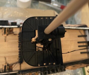

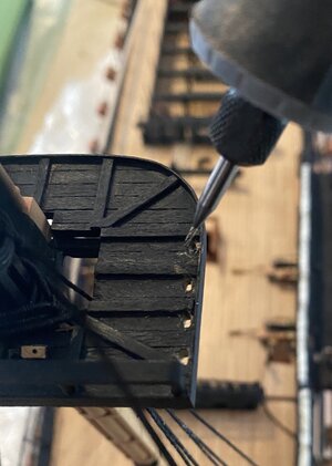

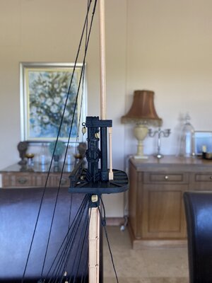

Good morning. When I woke this am, I needed to do something other than blocks and rigging...(and I have just started :rolleyes:). Decided to make the sleeves for my Mizzen top strops-as with the other masts I had to make these larger and more rectangle in shape to fit the brass blackened strops.
I drilled a larger hole and attempted with needle files as per the main and foremast - was going to break the crows nest. (Tip- never fit a mast until prep work completed) I put my “big girl panties” on and followed @Vfordyce example- used my dremmel tool with a small engraving tip. Came out ok however not as neat or linear as the other masts. Luckily the dead eyes will cover.

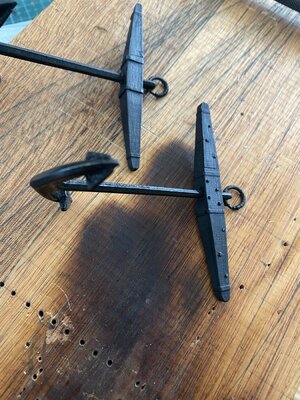

I started adding the “tree nails “ to the anchors. Used 6mm brass and left small amount protruding so they would be visible- painted.
Cheers Grant
Hello Grant. As you say the dead eyes will cover the slots, so no worries there. Your anchors look most authentic - well done!
