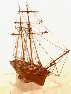

Is your decision about not making sails final? As I look at my royal louis I regret not making even rolled up sails. Ship would look much better but decision is up to you
Good morning. Thanks for this. Furled sails look awesome. I have not planned for sails however the way I’m rigging I could include these.If I do take this bold step I will only do furled but I have no idea how to do these. Thanks for the suggestion. Cheers Grant

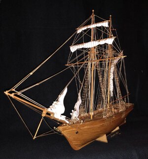

I added (furled) sails on my Scottish Maid. Not all, just a couple. To me it made the difference between just a model and a good looking model.
On my Black Pearl, the sails made it a bad looking model! On my Connie--not so bad. It's not easy making them look good.
Looks like it's a tricky balance. Guess I was lucky.
Perhaps best to try one first, see how it works.
I am still some ways off this call- At present hesitation is the name of the game. I definitely hear Vic’s wise words. A decision for another day for sure.

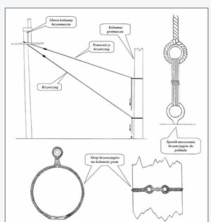

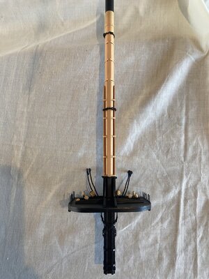

Good morning. I have been researching more rigging. This ship is a tangle of ropes- I will need to order more rope againCautious. The plans I have (Heller and my Mantua) run the stays from the Mizzen to main mast via single sheave blocks to the deck to be tied off.

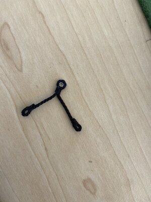

Super interesting is that these actually go through metal rings and not blocks (I think the British ran out of wood- (blocks make more sense). Using Longridge (the others Mackey and Goodwin also show this.) Pic courtesy of polish site.

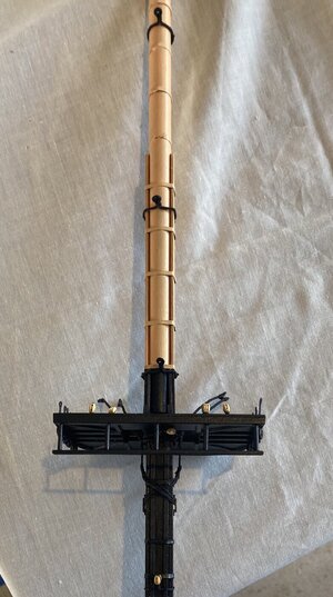

The 3 on the Lower main mast are for the Mizzen stays. The block on the top of the mast is for the top gallant stay(why this one runs though a block???- must be British....like a cup of teaROTF.
These only apply to the main mast as the main stay and preventor stay run to the bowsprit.The Burton pendants are also fitted.

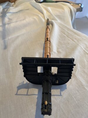

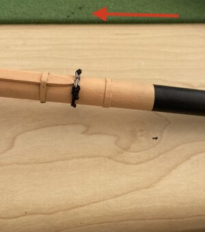

The lashings I have redone black - I tested the contrast but didn’t fit my ship. Red arrow- I got some paint on my pool table- got a bit of a rev from Arlene (the Admiral)Redface.
The frightening thing is how many more blocks still to go and for each block there is a rope....EishSpeechlessSpeechlessROTFROTF

Hello Grant, excuse me, just to inform you about certain stages of rigging equipment, I am attaching this page, I hope you can translate it
