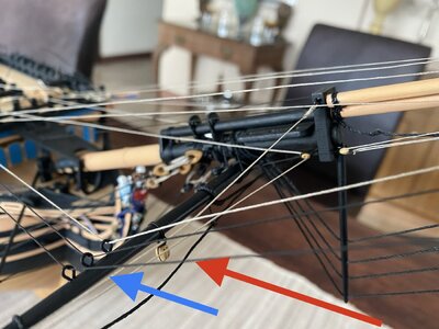

Good evening. I have been working on the bowsprit rigging off and on and here is where I have progressed to -
1;:The spritsail yard lift. Starts at the jibboom cap and through the yard block. Finished at the forecastle timber heads.(Blue arrow)
The red arrow shows the top sail inhaul line (no idea correct terminology) and blocks which also finish off at the forecastle timber heads.

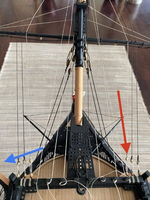

2:Next photo shows The spritsail and topsail yard brace ( blue arrow) I did correct these from previous incorrect positioning. These go from the forecastle 3mm blocks through the hoops ( on real ship these are rope) on the spritsail yard and topsail yard finishing off at various points on the bowsprit.
The red arrow reflect the rope walk through the stirrups. I made these with a 1mm thread (Per Mantua dimension)however I feel that a 0.5mm would be more realistic. I am debating redoing these to 0.5mm.

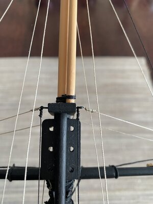

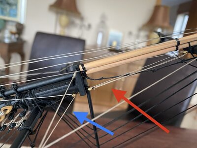

3: Next pic - The blocks for the yard brace are not linear but are at an angle as show by the blue arrow. As indicated I used 3mm double blocks and the color is black for the topsail yard and hemp for the spritsail. I have temporarily tied these to the forecastle. Debating wether I should just lash these to the end block- will look better.7037E5A5-EE88-466D-AACE-79F2D737745F.jpeg

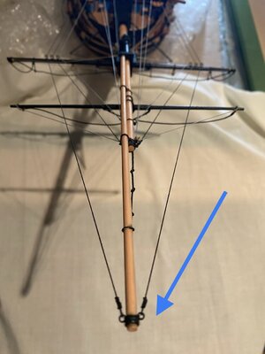

All the rigging has been whipped. Thanks to @dockattner cutting off the thread perpendicular has decrease my “tag” count...thanks Paul. The finishing onto the bowsprit was a bead bought from beads for Africa and looped onto bowsprit (blue arrow)

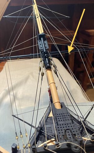

The clue line block was added to the spritsail yard - 5mm double block.( Yellow arrow).
I have not tensioned any lines. Temporarily tied them to the timber heads. The remaining bowsprit rigging will have to wait unti the masts and preventor stays are completed.
3: Next pic - The blocks for the yard brace are not linear but are at an angle as show by the blue arrow. As indicated I used 3mm double blocks and the color is black for the topsail yard and hemp for the spritsail. I have temporarily tied these to the forecastle. Debating wether I should just lash these to the end block- will look better.View attachment 302872

An immaculate rigging job, I'm severely impressed.
The stirrups should definitely be 0,5mm (0,5x78=39mm in real life), but that's from my perspective.

I love the feedback from guys who are in the know- much appreciated. Your post has made my decision for me- I will use 0.5. Eish- now need to redo these on the shipCautious.The 1mm just seemed out of scale. Cheers Grant
I'm not necessarily in the know, but sometimes I just run some calcs to see what dimensions things in real life have. That can be quite the eye-opener.
Sometimes you just follow the instructions, only to realize it "doesn't look right". Only thing to it is to redo the job to your own satisfaction.
I've seen the ropes, supplied with my BN kit and I'm not going to use those; too thick for my liking. The distance between ratlines is another pitfall; all too often they seem to be too far apart, wreaking havoc on the appearance of the model.
In the mean time, good luck with all the rigging trivialities. I'm confident your model will turn out great.
