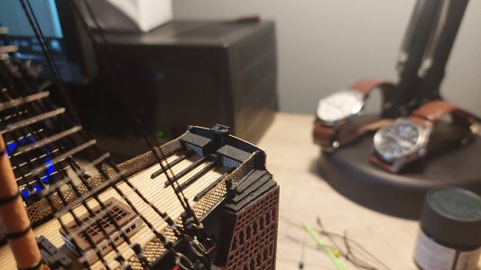

I cam across this picture of the the signal locker on Victory's poop deck, if it is of any use in your modelling. I have never seen it represented on a Victory model up to now.
Here's my poor attempt at recreating the signal locker at 1:200 on the poop deck using extra bits of wood from the kit. The cheap Chinese kit I'm using as a base is missing a whole bunch of parts

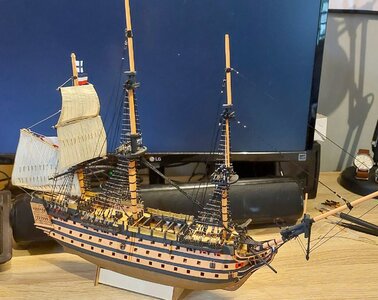

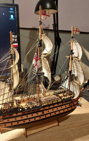

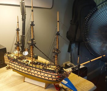

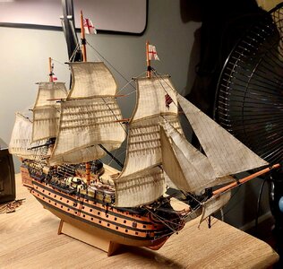

Here's my progress so far - making my way through the standing rigging then off to the yards & sails next:
That's a great effort at such a scale. Looking good

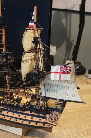

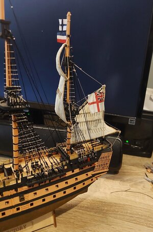

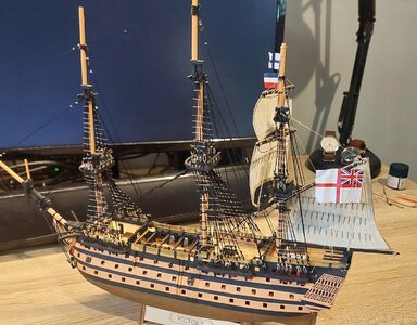

Update on the flag situation. I've just completed mounting the yards, sails and flags on the mizzenmast. Per this group's advice, I have a large white ensign flying from the spanker gaff and signal flags 1 & 6 ("Engage the enemy more closely") on top of the mizzen.
Please forgive the lack of deadeyes, blocks, etc. Didn't think they'd be practical at 1/200 scale; instead I used various combinations of knots and small jewelry chain links to achieve the "look" of rigging.
Will post more pictures as I complete the rest :)

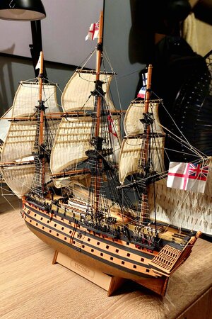

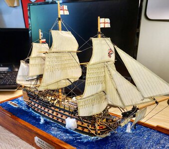

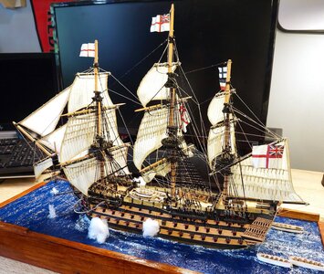

Here's my Victory now with all flags flying based off the excerpt provided by dafi:
"The Whole Fleet fought under White Ensigns. The Ships in general had 1 Ensign at the Peak, 1 in the Main Rigging & a Jack on the F.T. Mast Stay..."
So I've got White Ensigns flying at the stern, on the mainmast and in the main rigging; signal number 16 flying on the mizzenmast; rank flag of a Vice-Admiral of the White flying on the foremast; and lastly a jack hanging on the fore t'gallant stay.
I thought it weird at first to have so many ensigns flying, but apparently this was favored by Nelson:
"In going into action it is the custom with the ships of all nations to hoist their national colours. Nelson at Trafalgar carried this to excess, for he hoisted several flags lest one should be shot away."
And so here we are. Thanks everyone for the help, and now on to the guns!

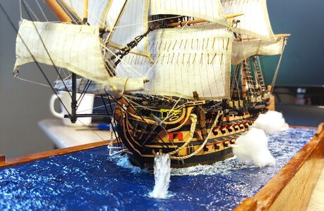

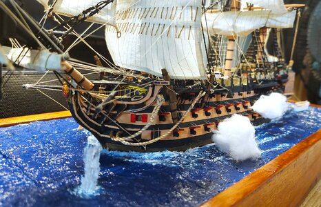

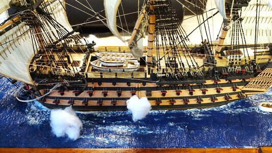

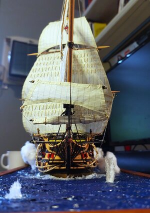

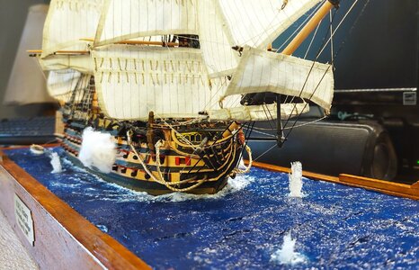

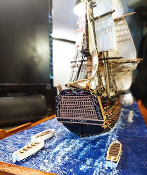

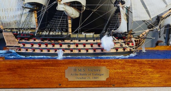

Last update for this project. I finished the cannons and gun ports. I then added a papier-mache base to simulate water within a wood case finished with some lacquer. I used cotton balls to simulate smoke and some clear caulk to simulate splashes from the Franco-Spanish cannonballs.
View attachment 416926View attachment 416927View attachment 416928View attachment 416929View attachment 416930View attachment 416935
View attachment 416931View attachment 416932View attachment 416933View attachment 416934
Wow! I can almost hear the roar of the cannons!
