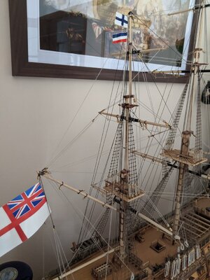

Lieutenant Pasco (Nelsons' Signals Officer) was stationed at the after end of the poop deck which is where the flag locker was situated. This is where the famous signals were hoisted from and my understanding is that the signal flags were hoisted to the mizzen top. That is where signal No. 16 would have flown when breaking the line. The White ensign at the stern and the union jack on the bowsprit would be standard as you know, but I can't offer anything on other flags. Incidentally, although my Victory model isn't rigged with sails, I did hoist No16 at the mizzen top! Best of luck with your project. It sounds pretty awesome.PXL_20230916_145340393.jpg

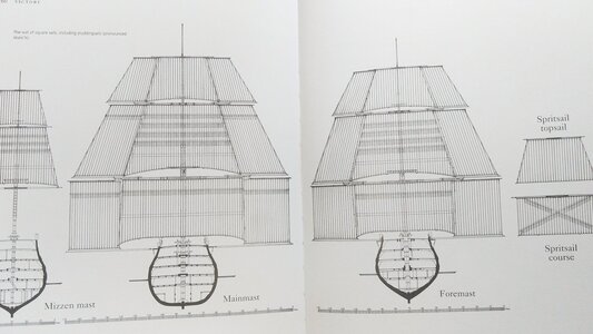

Some contemporary paintings show Victory fitted with royals early in her career, AND at Trafalgar. Although I have seen many models of Victory over the past fifty-odd years, none were fitted with royal spars. Does anyone know if Victory ever actually carried royals? Are plans/drawings of this arrangement available?
Lieutenant Pasco (Nelsons' Signals Officer) was stationed at the after end of the poop deck which is where the flag locker was situated. This is where the famous signals were hoisted from and my understanding is that the signal flags were hoisted to the mizzen top. That is where signal No. 16 would have flown when breaking the line. The White ensign at the stern and the union jack on the bowsprit would be standard as you know, but I can't offer anything on other flags. Incidentally, although my Victory model isn't rigged with sails, I did hoist No16 at the mizzen top! Best of luck with your project. It sounds pretty awesome.View attachment 394869
Thank you. I suppose this adds another possible consideration. I think I like this configuration better with the signals on the mizzen top since it frees up the main top for the Admiral's rank flag. It makes more sense to me: in most paintings of the era, I always see the commissioning pennant on the main top, but apparently this is replaced by a rank flag when there is an admiral on board. It would make sense that the rank flag would also therefore be placed at the main top.
Thank you. Though my understanding of the events at Trafalgar is that Nelson's famous signal was sent to the fleet a 1-2 hours before the actual battle. During the battle, only signal No. 16 was flying: "Engage the enemy more closely."
Yes, the famous signal was sent in advance of physical engagement. Incidentally, it took 12 separate hoists to convey the message, eight for the first eight words and five to spell out the word DUTY. Each hoist would be hauled in sequence to the top of the mizzen mast, remaining there until acknowledged by the other ships. Quite a laborious business!

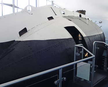

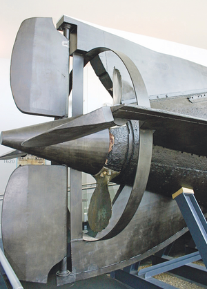

Holland 1 on display: the outer hull is well preserved. The Holland Gallery at Gosport is maintained at less that 40% relative humidity. Visitors are able to look inside the submarine and see its internal mechanisms. (Pic: Robert Edmonds)

I have done some research myself now and see the problem. I have seen paintings of Victory with studsails and royals set, others with just studsails sn some witout either. Very confusing. Slightly more helpful, though not conclusive, is note in my copy of John Mckay' "Anatomy of the Ship - the 100 Gun Victory" stating that First Rates carried Royals for fore and main masts. Another source , Alan McGowan's "HMS Victory, Her construction, career and restoration" is full of plans from original historical documents. The sail plan shows studding sails, but not Royals. I can find no reference to Royals in any of the accounts of the battle, so I think the jury is still out. I would be interested to hear if you ever get to the bottom of this quandary.

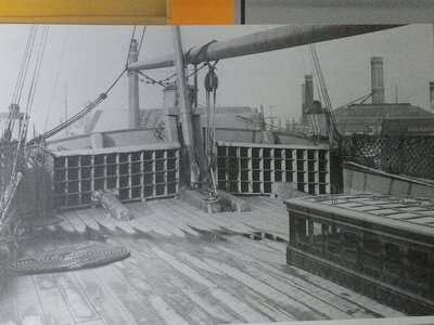

I cam across this picture of the the signal locker on Victory's poop deck, if it is of any use in your modelling. I have never seen it represented on a Victory model up to now.
Take a look at dafis Victory in 1:100

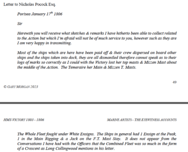

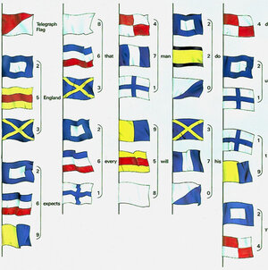

Yes Nelsons famous signal was taken down long before the battle. As mentioned above correctly, signal Nr 16 was up until the frensh took it down with the rest of the mizzen. Here an contemporary source of what was set in general.

That's them, sitting on top of the locker!
