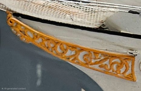

The 1:120 model of Nippon Maru (tied up in Yokohama, Japan) came with totally inaccurate bow decorations, and they were decals to boot, just terrible. Chat GTP worked up some printable .stl files which I printed and voila! Accurate bow decorations.
