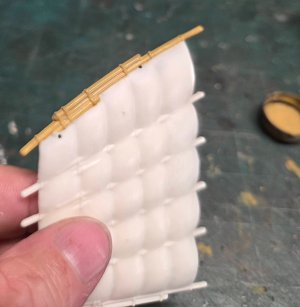

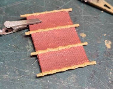

The sail treatment will be the hardest due to the contrasting colors of the dark red sail (either Tuscan or Box Car Red) and the bamboo battens, which are very light/bleached tan color. I’m going to do my best mask and airbrush these vs. hand paining if possible. The kit provided rigging blocks but I’m not too sure they are accurate, so some more research is needed.

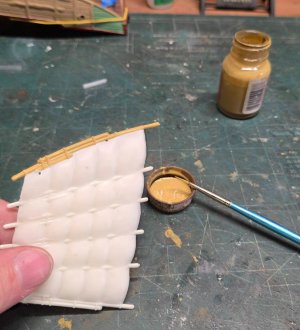

Not a lot done today, just fitting and gluing parts on the deck, weathering and washes. There are 2 shades of yellow, all bamboo parts are Floquil Polly Scale Depot Buff (water base), including the 7 larger bamboo stalks that mount on the outboard sides of the boat., this color is so close to real bamboo, you have a hard time see a difference. The deck trim (dragon, framing, ladders, etc. are Floquil Sp. Armor Yellow. The Dragon background is Boxcar red with drybrush gold for high lights.

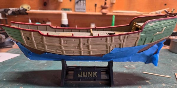

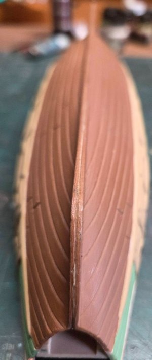

The hull was test fitted with the deck in place to see if there would be any fit issues, The inner bulkheads were washed down to darken, I won't wash the outside till its assembled because I need to fill and sand down the seam where the hull meats to get rid of the gap.
In case you're wondering that section above the rudder is not missing anything, it's actually open like that - strange if you have a following sea, they going to ship water quick.

Got the hull sitting up, deck in place along with the transom. Bamboo bundles bound and the snake trimmed out along with the eye. The hull looks strange because I have not dirtied it yet, clean on the outside, dirty on the inside.

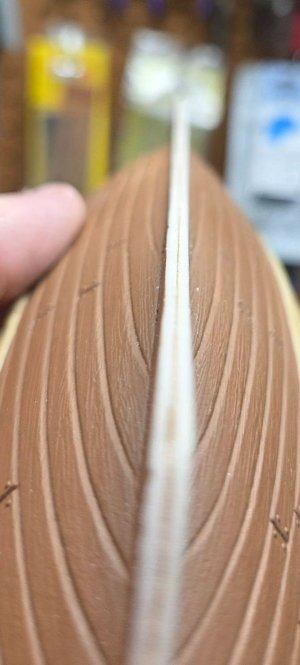

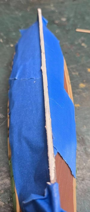

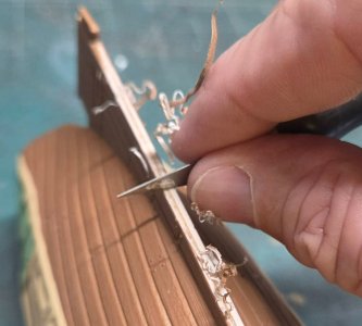

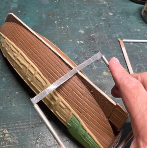

Now that the hull is together, I had to remove the seam, no matter how good the model is, you're going to have a seam. You scrape it down to level then using a Flex-I-File you sand it down to take the hard edge off. Then fill the gap with thin Tamiya modelers putty, the tape is the to keep the putty off the side, makes for an easier clean up.

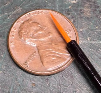

The micro brush I'm using is the same ones they use in nail salons, use them once, then pitch them in the trash, you can't clean as the bristles fall out. They come in a pack of a 100 for $7.00 at Amazon.
I did the base coat trim in for the bamboo thatch roof over the rear hatch. The SP Spanish Yellow is water based and the red color will be an enamel; this is so the two colors won't blend much. I'll go back and trim in the red then dry brush and wash
