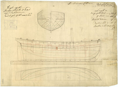

Scale: 1:48. Plan showing the body plan, sheer lines with inboard detail, and longitudinal half-breadth for building Sherborne (1763), a single-masted 6-gun Armed Cutter at Woolwich Dockyard, based on the lines of the purchased Armed Cutter Pitt (1763). Note that the deck, waist and windlass were altered.

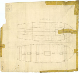

Scale: 1:48. Plan showing the hold with bulkhead arrangements, and deck plan for building Sherborne (1763), a single-masted 6-gun Armed Cutter at Woolwich Dockyard, based on the lines of the purchased Armed Cutter Pitt (1763).

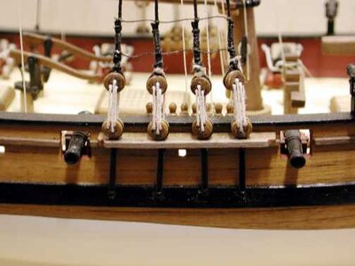

She had also this chasing gun port, but definitly no possibility to move a gun forward. Also there was no possibility to install lids

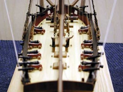

All together she had 10 gunports, but definitely was only armed with 6 british 3-pounder guns and swifel guns

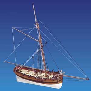

Jotika has a good kit of this Sherborne (1763) cutter in scale 1:64 - Jotika is mentioning 8-gun cutter and also the kit contents 8 guns (which was not correct)

Uwe, this is so informative. Thank you for taking the trouble to present these photos and commentary. Another thing I notice that interests me is the inclusion of the flue pipe from the hearth down below in the cabin. I will try and include that in my model. It is an important human element. With a wood fire below, I can imagine life on these craft as just bearable. Without, it would be cold and deadly.
I like the hybrid lids. Coincidentally, I was just reading that the USS Constitution had lids like that.
