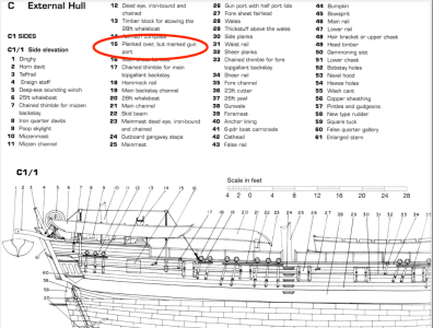

In answer to your other problem refference the rear gun ports, this it somewhat of a degree is a mistake of OcCre, the Beagle did have these ports whan it was built, but in the refurbishment before Darwin's trip they were planked over, see attached drawing.

The Beagle was modified for exploratory use in 1832 (? from memory). The main deck was raised about a foot to provide more height for rough seas and cabins were added. The forwardmost gunport and aftmost gunports were sealed because of the cabins built behind them. They were apparently still painted as if they were active; but they were not accessible for use. I assume this was for "shock and awe" optics even though one would assume it might have been more structurally sound to have just planked them over in the modification/retrofit. The Beagle as outfitted for Darwin's journeys was not well documented.
I've started planking my Beagle but something is not right. The fore and aft gun ports are in inaccessible places with the aft ports having a wall directly behind them. Do I cover them with planking or leave as is?View attachment 575481View attachment 575482View attachment 575483
Looking at other builds I think your interpretation is correct. Other pictures show the bulkhead through the cannon port the same as yours. So I guess you put a cannon port lid over the hole?? Cover up OcCre's poor design.
As we say, it's only wood and string, you can do anything you want to remedy their error, but this would have to be done at a suitable stage of the build. You have progressed too far to correct this so the best option is to put a lid over it.
