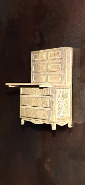

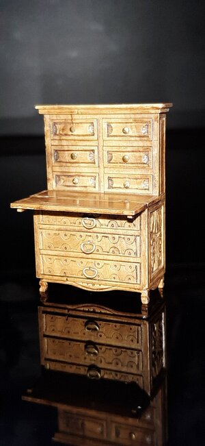

We here in the EU can just buy Judea Bitumen at every art store. It is also used by furniture makers.
Se an example below of a wash of judea bitumen mixed with turpentine on a boxwood carved cabinet made for my Royal Caroline.
Before bitumen
After bitumen
It enriches the colour and brings out the carvings.
