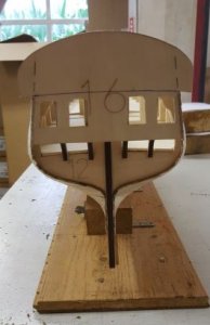

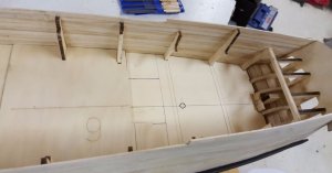

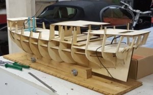

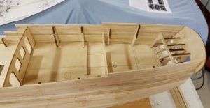

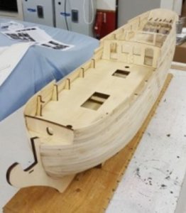

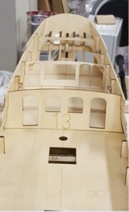

These photo's show the new layout of the hull with the stern cabin structure opened for building the inside cabin.
The ribs in the rear are opened to make space for the rear cabin, the rear cabin floor is added. Changes are made according the drawings that came with the model and are from the book anatomy of the ship.

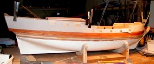

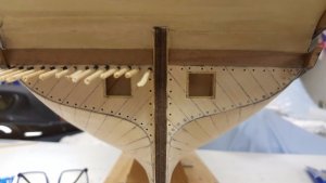

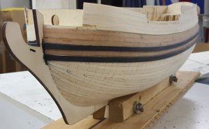

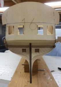

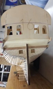

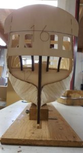

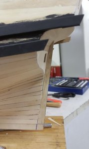

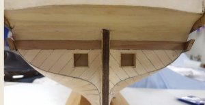

The stern of the kit is changed according to the drawings, I have added some extra ribs to the lower stern adding 6 mm close to the stern post and 2 mm on the outside edges. This is creating a stern which is slightly bollow. These ribs were planked horizontally with the first layer of planks and with and diagonal with the second layer of planks. All planking is blackened on one outside edge to create the look of the hemp and tar which was used to watertighten the ship.
After adding the additional ribs they clearly their effect in the pictures below. I have also added the gun port in the stern.
The next time I will upload the pictures of tree nailing the hull with some 5 to 6000 beechwood cocktail sticks, on which I am currently still working.

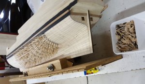

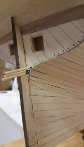

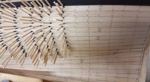

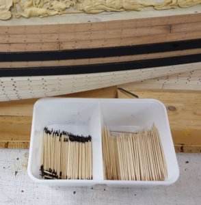

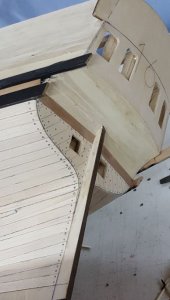

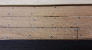

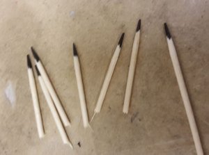

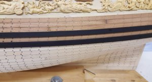

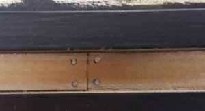

This part is showing the tree nailing of the hull on the port side of the vessel. For the tree nails I have used beech wood cocktail sticks, don't use bamboo for this. The tip of the stick I have blackened with a black marker to create the illusion of hemp and tar as with the planking of the hull. For the tree nails I have drilled holes of 0,8 mm, to size this would be 16 mm which seems a proper size to me.

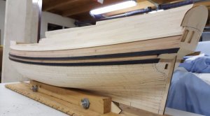

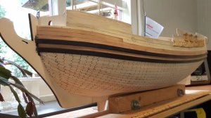

On the side of the hull I have set out the ribs of the vessel according to the drawings. On these ribs I have drilled the small 0,8 mm holes for fitting the wooden pins. The wooden pins are glued in place and after drying cutted with a fine side cutter plier. After that the tops of the pins were filed with a fine file followed by sanding. When finished I will put the hull in oil or in bee wax, don't know yet what will create the best look and feel.
Hedgehogging the hull.
Setting out the top whale, for this purpose dry fitting of the boxwood ornaments.
Fitting the planking above the main whales.
Below a detailed view of the drilled holes, the cocktail sticks fitted and cut, and right below filed and sanded.

Fantastic treenailing. I love the effect of blackening the ends. Very realistic looking. Thumbs up on this one !!!

Donnie thx, I am also very happy with the effect but it is a lot of work, already working some weeks on it to do the whole hull.

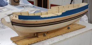

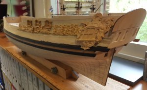

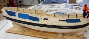

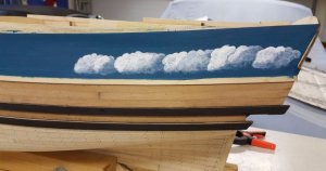

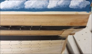

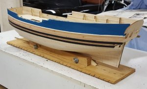

In between I am also working on the blue color above the top whale and painting clouds on this as shown on the drawings. For the Turqouise color I have selected two small samples of matt wall paints and finally ended up mixing them to get the color I wanted.
The finall color selected is the one at the bow, a mix between the the light Turqoise blue with the dark Petrol blue.
On top of the blue on the aft side according to the drawings a cloudy sky is painted, this was on 17th century Dutch vessel a common feature. I haven't seen it on a lot of models of the RC but I gave it a try.

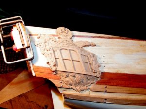

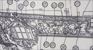

See below the part of the drawing where you can see the clouds just behind the ornaments behind the aft cabin window until the stern of the vessel. A small part of these clouds are part of the carving behind the rear cabin gallery in the model of ZHL but do not return in the rest of the carvings.

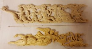

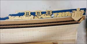

See below one ornament carving which is already worked on and the bottom one treated with clear beewax.
Finally a preview of the ornaments on top of the clouded sky. The ornaments are not worked on yet.
The current status is that I am working on the nails in the lower whales. I haven't burnished these as the whales will be repainted black.

G'day Maarten, you were asking about tips, the only thing that I see is that at the stern you have three planks above the wale, in the video's and photo's it shows three planks at midships tapering down to two at the stern, I questioned this myself but after some measuring I tapered the planks down to two planks at the stern. The template they supply also shows two planks at the stern, it might be too late for you to change it now or maybe you have come up with another solution, just afraid you may run out of space for the carvings or you might have to raise the painted planking higher which it looks like from your photo's.
I dont mean this as a negative comment just trying to be helpful,
best regards John.

I have seen that zhl changes the the size of the planks from 3 to 2 but I think this is not correct and gives a different look and feel in the flow of the whales which are determining the layout of the vessel.
I have been dry fitting before setting out the finall whales and will fit the carvings like on the drawings of the anatomy book. In these the carvings are partly integrated in the top whale. My blue area is now bigger then it finally will be. Hope everything works out fine, we'll see.
