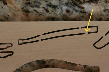

what do you mean with oversized? I prepared my frames 0.2 mm thicker than necessary to hame alittle bit of wood to egalize some tolerances. At the joints I reduced the thicknes to create room for the glue. Without this space every frame will be a few 1/10 mm to big.
When Mr. Hunt CNC cut the billets he cut the parts slightly oversized, and the modeler must adjust each piece to get it down to the correct size. In the instructions he explains that you can 'see' the amount of oversizing by noting the dimple created when the milling head dropped into the wood. The modeler then must sand the piece down to the dimple to get to the correct dimensions.
For example, see the image below (a tiller?). The yellow arrow indicates the dimpling. After removing the part from the billet I will then need to sand down the part to remove the dimple. On a tiller it hardly matters - but on pieces that are size critical it can be tricky to remove the right amount of wood on every cut surface. I've gotten into the habit of counting sanding strokes to add a bit of reproducibility.
Anyway, I hope that answers your question.

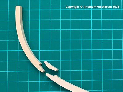

Now I understand, what you mean Paul. The small circle at each notch I have also after cutting the parts. By me it is less but visible. It's by me part of the 2/10mm I made the frames wider than necessary.
In the moment I would say that you do not need to think about this. I would only fair the frame parts until the rests of the small notches are no longer visible. The rest you can best sand after glueing all frames to the keel. For this follow Antscherls suggestions.
You are building your model by hand and if the frames in the end are 1/10mm thicker or thinner than given by the design, no one will see. Or do you think that the former shipbuilds do not have small tolereances?
Edit: In the picture you can see this notch after prefairing the long toptimber of one frame of my Alert project.
