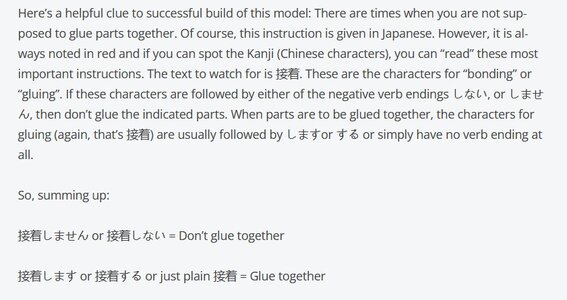

So according to the link provided by Dematosdg these are the phrases that I should be looking for:
接着しません or 接着しない = Don’t glue together
接着します or 接着する or just plain 接着 = Glue together
Now I am beginning to get a bit scare about this build because I will always be on the look about if I should glue or not the piece that I am working on.
I guess this will be a model that I shouldn’t rely too much on my experience and double check the ilustraciones provided.
Rossc83,View attachment 281415
This is what I found when I was building Woody Joe's Higaki Kaisen. The same will apply for your build.
Slow scanning of the Knaji and sharp eyesight will be essential for the correct outcome. Skilled linguists are irreplaceable with some models/instructions. RichRossc83,
Thank you for clarifying the texts that I should be looking for.
I will take your advise when building.

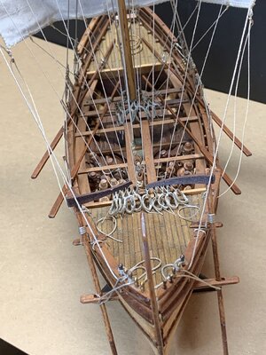

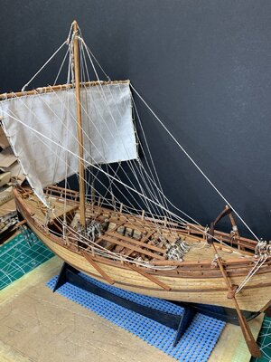

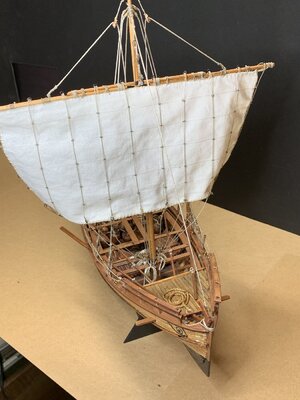

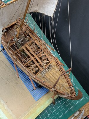

Thank you.I am curious when you completed your Kyrenia model and any photos of that. I spent a lot of time in small detailing of my own model which will be given away in the next month. Rich (PT-2)
I modified the kit also but did not know how to mold the amphorae so turned some on a small lathe which were oversized for the scale of the boat. I would like to have a translation of the materials used and method of making the mold and castings for my present scratch Phoenician trade ship project.Thank you.
It's a Kit from ZHL models with my own modifications. You can see on http://construyendo-barcos.blogspot.com/. Sorry is only in Spanish blog.
